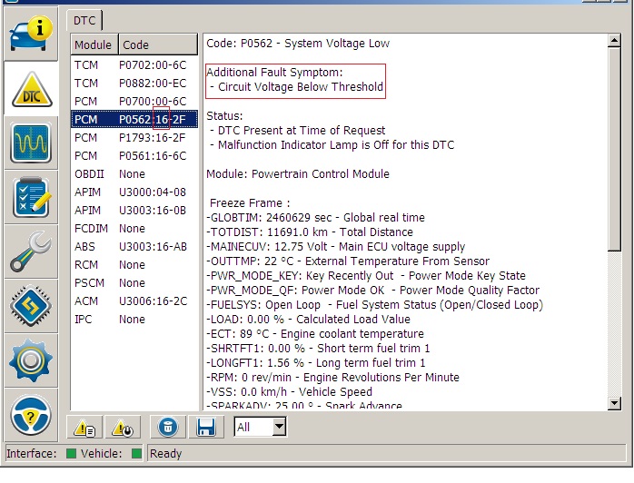

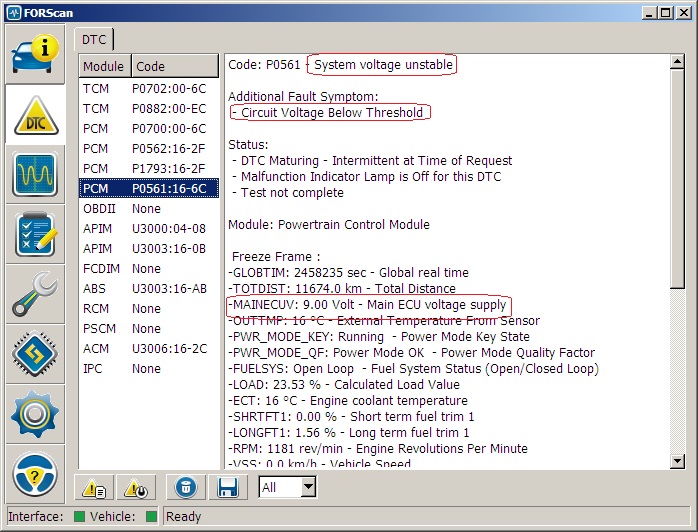

Ford Ecosport Europe 2014, less than 2 years old, 11700 km. Unstable start of engine(after 2-3 attempts). ABS, TCM, EPS malfunction lamps light up right after the start and SYNC asks to visit a workshop urgently. Car owner is in panic. After connecting FORScan a lot of diagnostic trouble codes were read. Although this may look like a serious global trouble, or even multiple troubles, brief analysis shows that almost all of these codes indicate low/unstable power voltage:
Considering that multiple modules report approximately the same, the only explanation is that the battery died. To confirm, read VPWR PID in PCM module in KOEO and KOER mode. It shows 10.5 in KOEO mode (that’s too low – should be around 12) and 14.5 in KOER mode (that’s normal and means the alternator/charging are most likely fine)

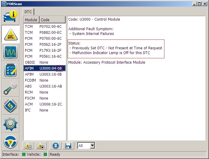

Finally, 2 more screenshots that illustrate what are the sub-code (Additional Fault Symptom) and Status and how FORScan displays them:
Sub-code
Sub-code
Status
Status
