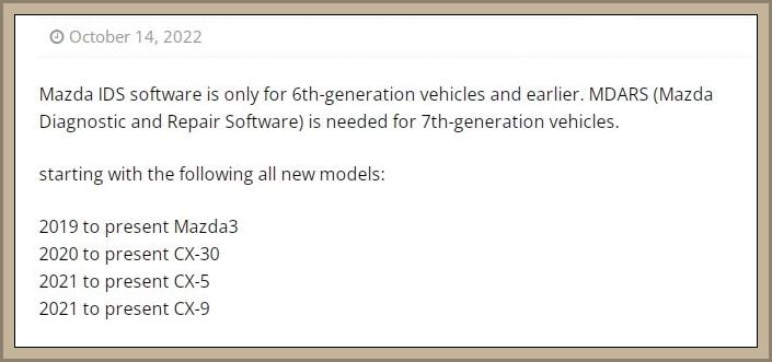

New 2019+ Mazda 3 are not supported ... By ForScan
You would need: MDARS (Mazda Dealer and Repair Software),
What vehicle(s) does MDARS support?
A: MDARS is used on Mazda 7th generation vehicles starting with the following all-new models:
Mazda list.jpg (27.89 KiB) Viewed 857 times
