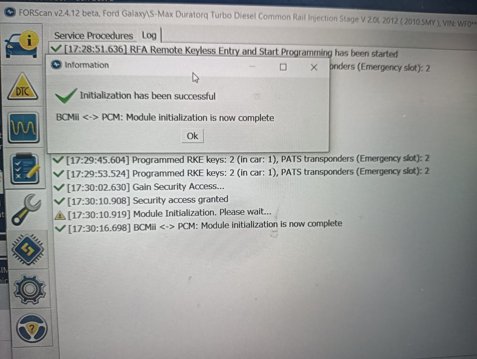

Many thanks to the forscan team.
after downloading FORScan v2.4.12 beta and using the Vlinker FS, i have eventually been able to gain entry to my pats that was using the 'new' algorithm with an outcode starting '1144' to program a used PCM on my 2012 SMAX 2.0TDI 163 powershift!
