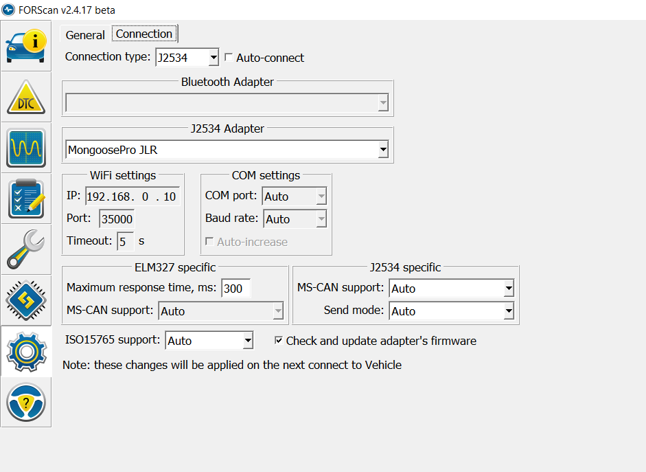

Hi All,
I have a paid license for Forscan. I have been using this for months and had no issues. I am using a genuine Mongoose JLR adaptor and up until today I was able to see all modules fitted to my 2023 Transit Custom. Today when I try to connect I can only connect to 3 modules, PCM, OBDII and BCMii. I have double checked that my Extended license is ok, so I installed Beta and it is also the same. I have always used this Mongoose JLR and always had access to all modules until today. I also have a genuine UCDS V5 adaptor but it also only sees 3 the same 3 modules.
Any help would be greatly appreciated, thanks

SOLVED !
I rolled back to 2.3.62 and now can see all fitted modules
