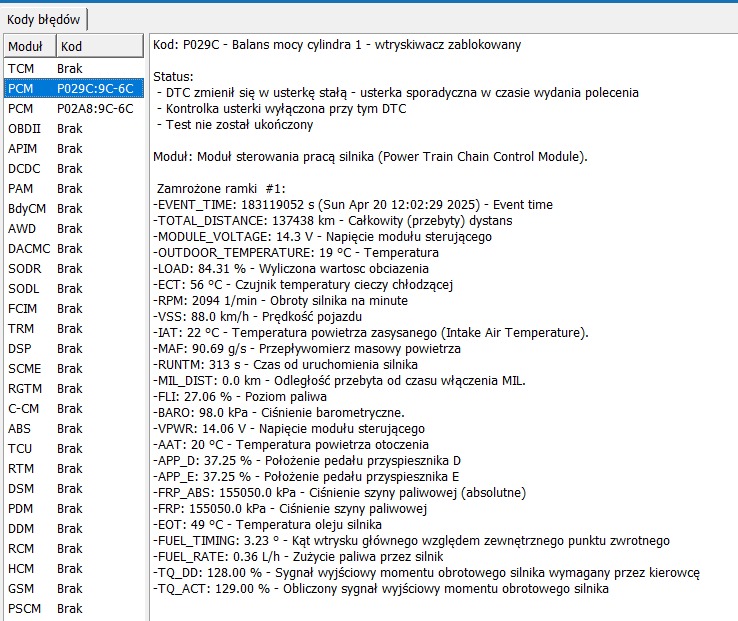

Hello guys.
I have a 2019 Ford EDGE 2.0 TDCI with a 176KW 4x4 engine with 8F57.
I have a problem with fuel injectors that do not dial correctly. I wanted to use Forscan to perform the procedure of checking injector codes and resetting parameters, unfortunately each service procedure is interrupted by the program. I tested on various communication modules Vlinker MC + has the latest firmware and Vlinker MS, I tried using a PC win10pro with a 2-month trial license and from Android with a paid license, each time the functions are interrupted. What could be the cause??? :roll:
Battery voltage above 12V. :idea:
