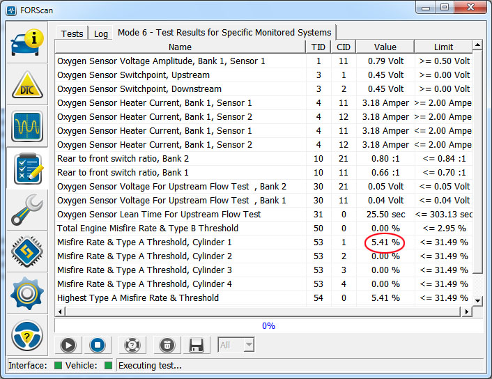

Good tool for intermittent misfire diagnostic is OBD II Mode 6 tests. FORScan has Mode 6 implemented in version for WIndows only (for pre-CAN vehicles it is available, for CAN models it is implemented in v2.3.9 that is not released yet). Tests section will be added to FORScan Lite for iOS and Android) in one of nearest releases.
This is how it may look like for pre-CAN cars:
FORScan supports Ford-specific Mode 6 tests (Mazda has another set of specific tests that will be added in the future).

Curious, how does one access "mode 6"? Thanks!

ALRUI wrote: Fri Oct 05, 2018 9:12 amAnyone?
Look at the pic above. The test is under the "clipboard" looking tab in the left column.

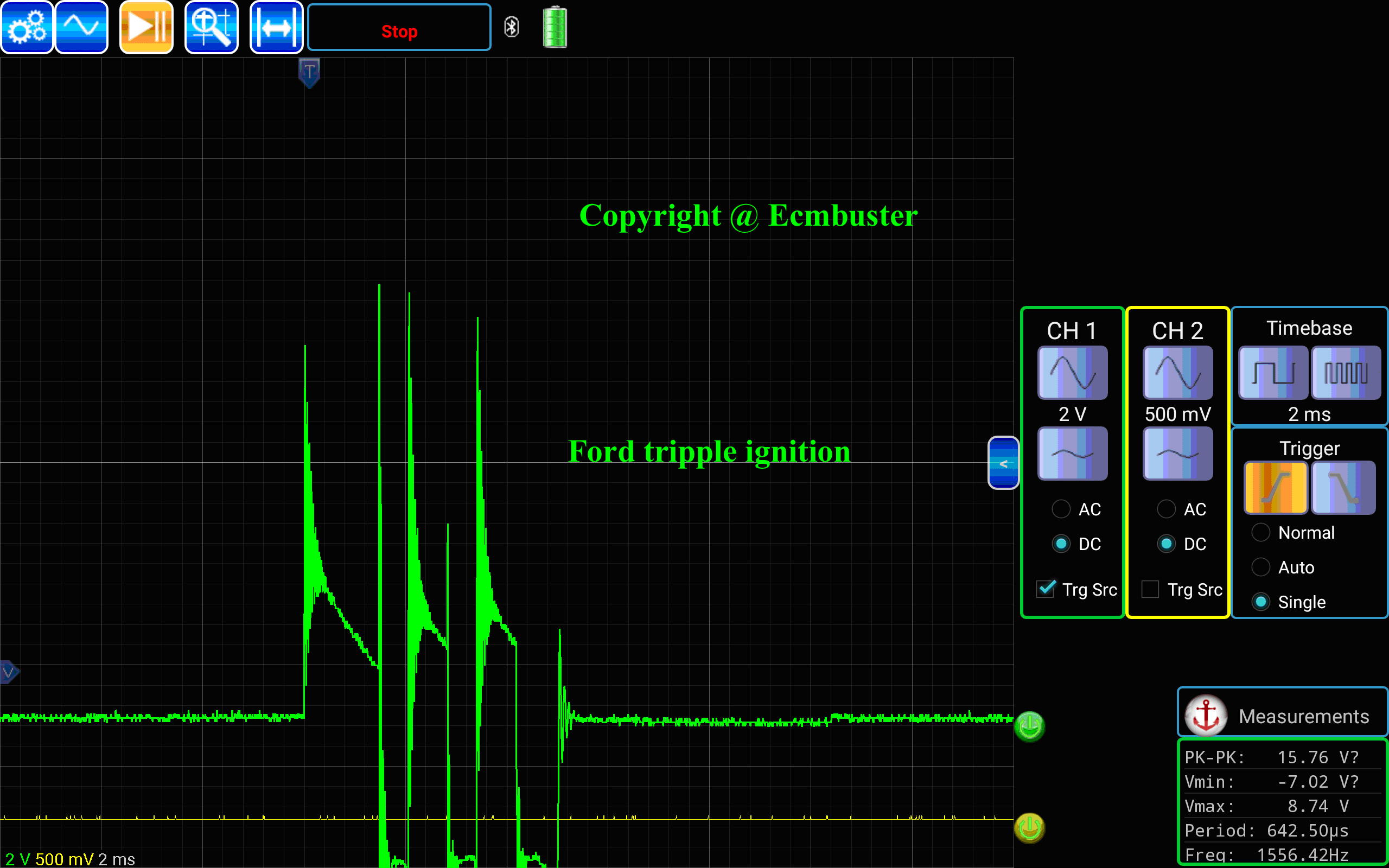

With a simple oscilloscope and capacitance paddle, the ignition system is revealed at the top of the ignition coil.
Ford Scope.jpg (887.77 KiB) Viewed 33570 times
