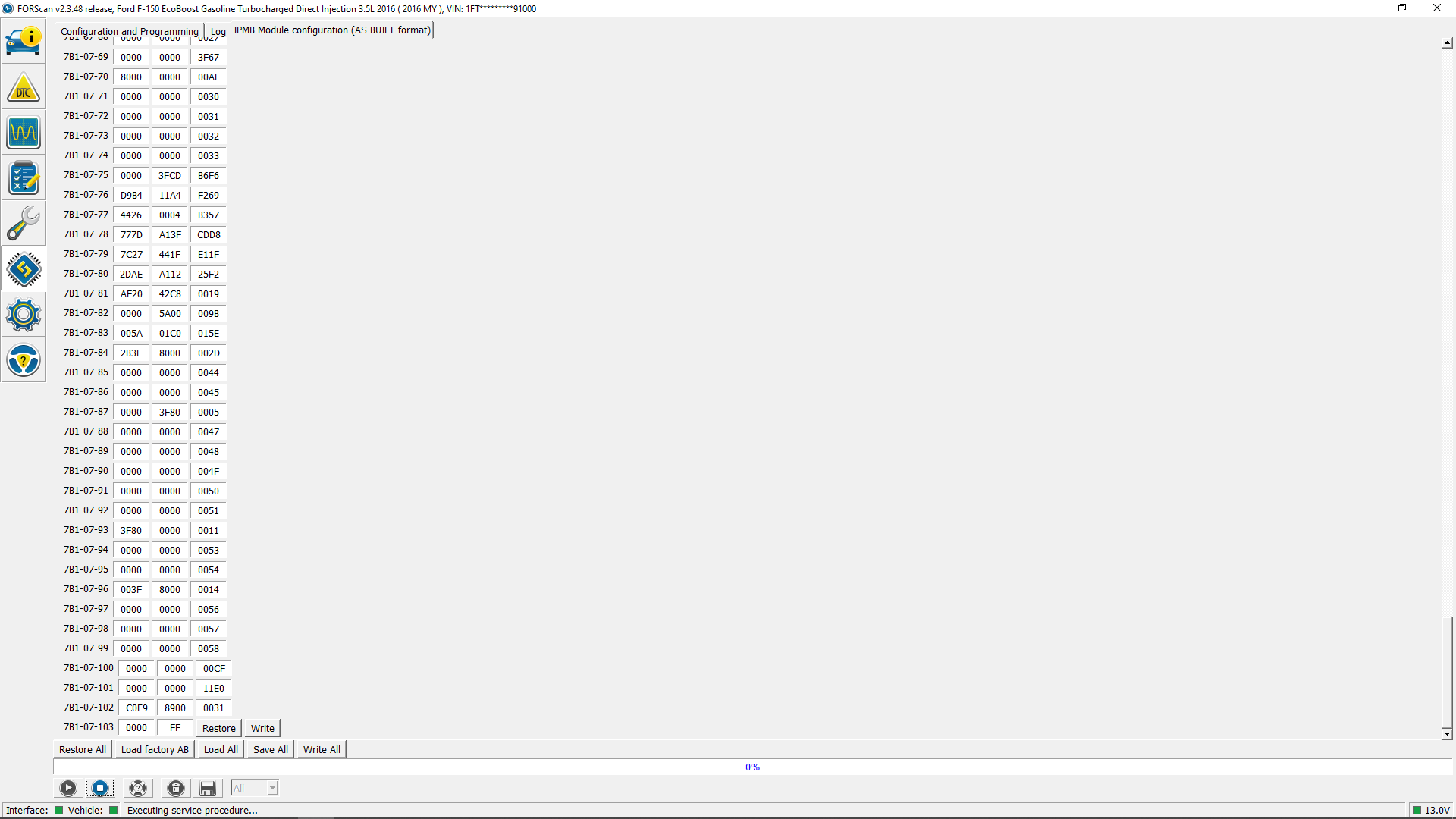

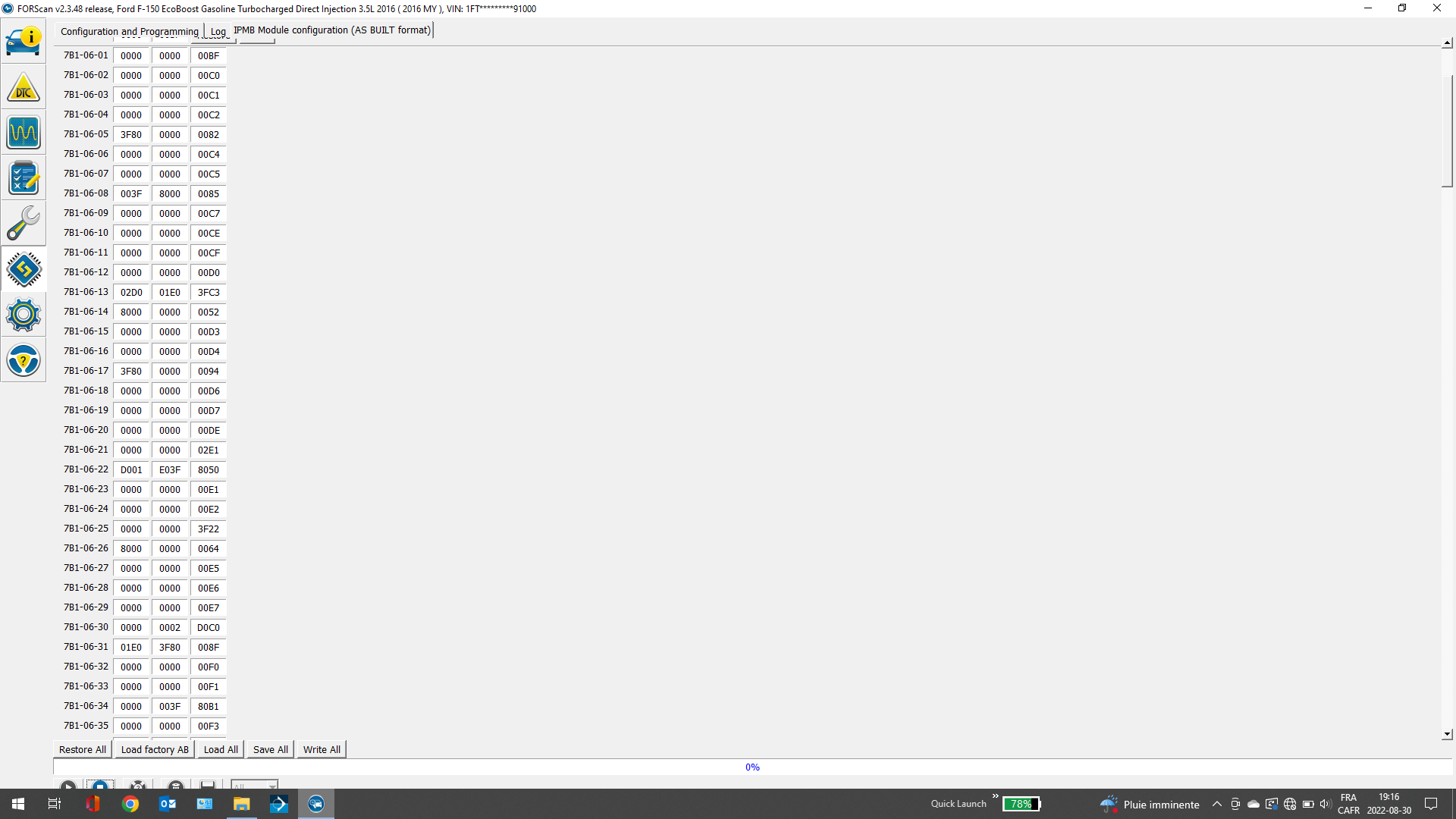

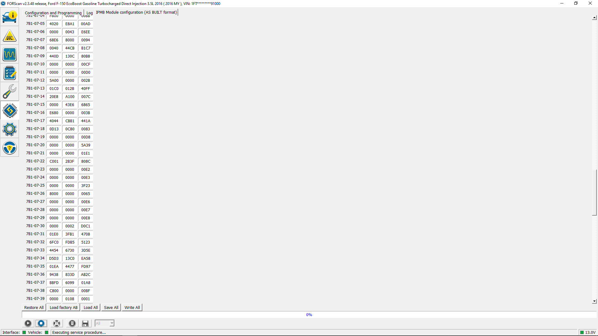

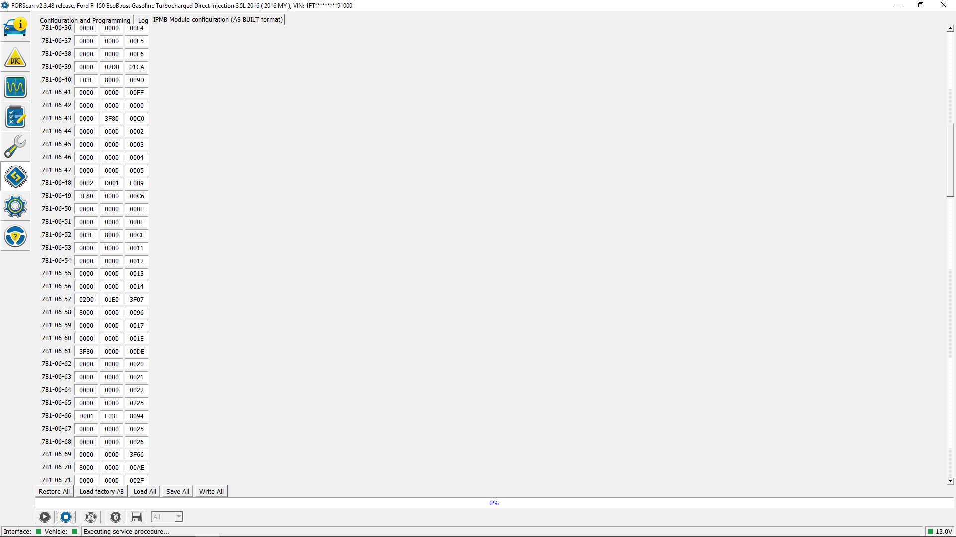

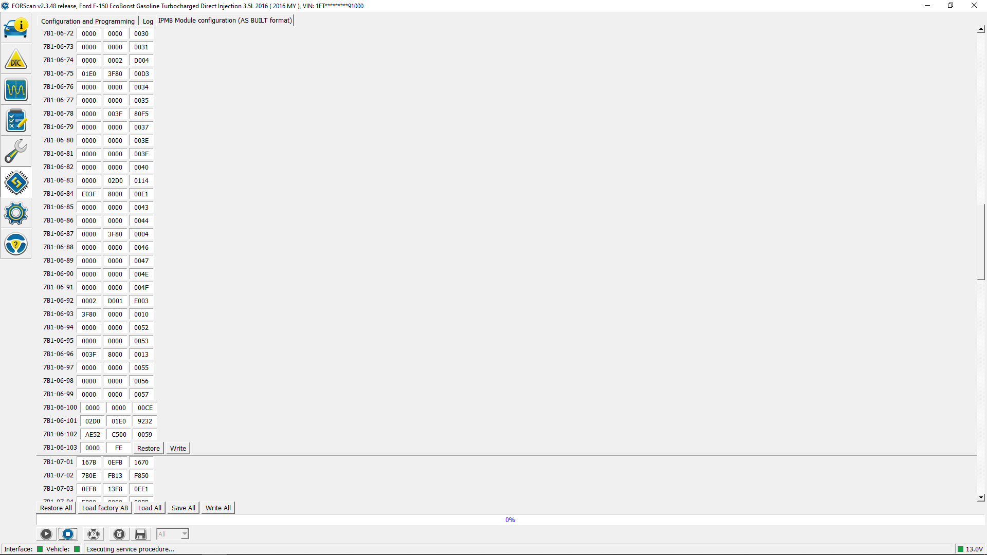

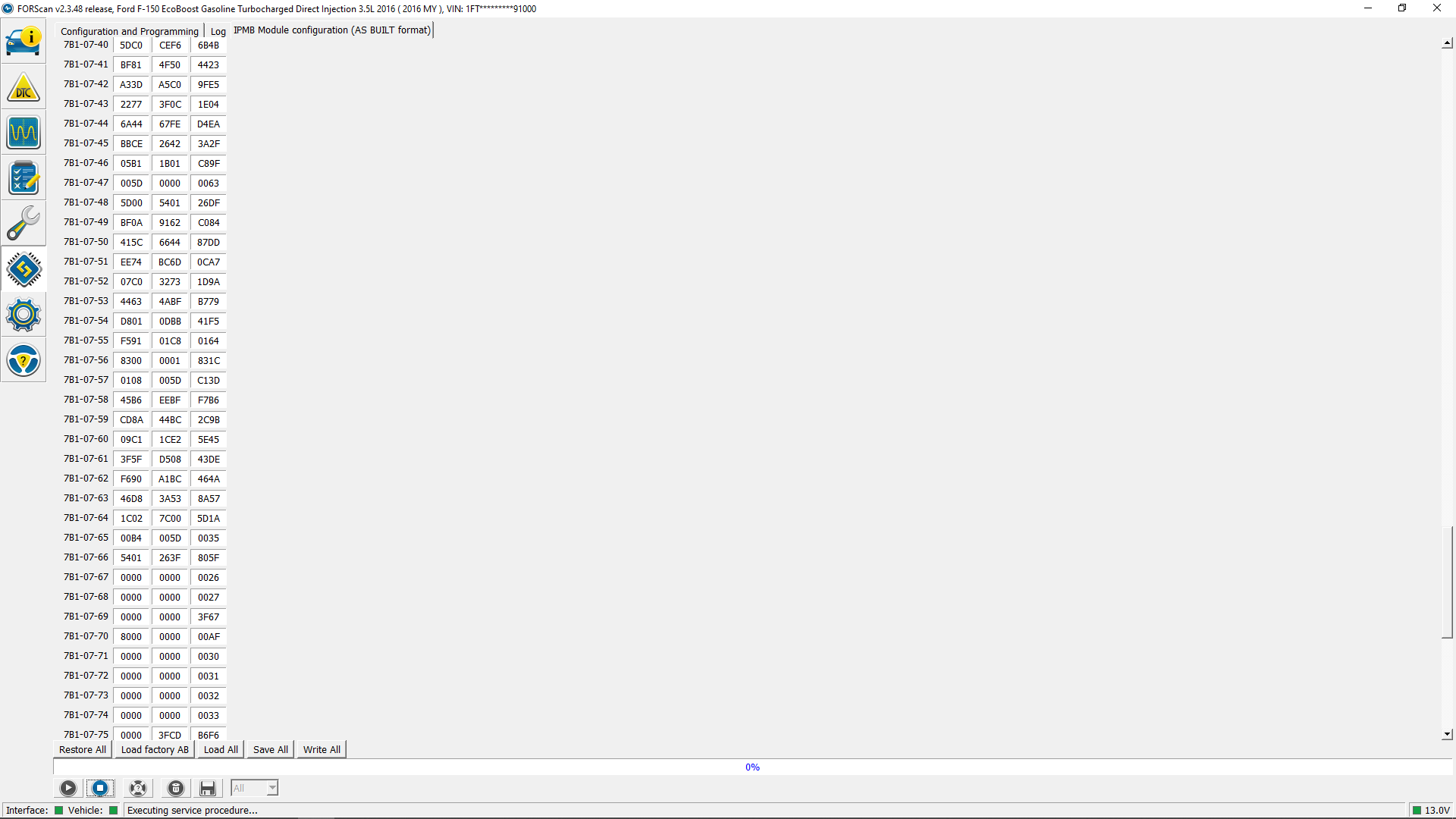

Bloc 6 and 7 are the Focal Center and Homography Calibrations of caméra I have a 2016 F150 Lariat with 360 degrees camera and I'm able to upload these two bloc.
The part number of my IPMB GL3T-19H423-AD
Initiale calibration files GL3T-14F017-AE = No bloc 6 and 7
Update calibration GL3T-14F017-AG the new bloc appear and screwed up my camera calibration.
Now I need to test with somebody who can upload the As-Built with the same calibration files as me with 360 degrees camere Crew Cap 6.5 feet box and can dowload in min to know if it's true.
The link came from Cyanlab https://cyanlabs.net/asbuilt-db/ipmb-20 ... -database/
Go to database and IPMB 2015-2020
Capture d’écran (110).png (104.8 KiB) Viewed 5232 times
Capture d’écran (109).png (110.91 KiB) Viewed 5232 times
Capture d’écran (108).png (107.1 KiB) Viewed 5232 times
Capture d’écran (107).png (105.27 KiB) Viewed 5232 times
Capture d’écran (106).png (103.5 KiB) Viewed 5232 times
Capture d’écran (105).png (147.69 KiB) Viewed 5232 times
If any question let me know
