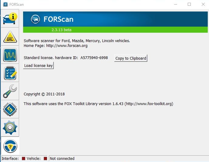

I installed Forscan on my PC running WIN 10...and yes there is a Problem with actuating the extended license...
This is what I did...

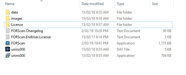

Download the extended license...make a new folder and name it License. Put the extended license .key file in to that folder.
Go to Windows (C:) and find the FORScan Folder... Mine was in Program Files (x86)
Paste the " License Folder " in to FORscan...
Or: Right click on ForScan shortcut, Properties, Open File location...put License Folder in there.
Next:
Open the FORscan program
Click on [ Load License Key ] and this should take you here ...
Open License Folder and take it from there...

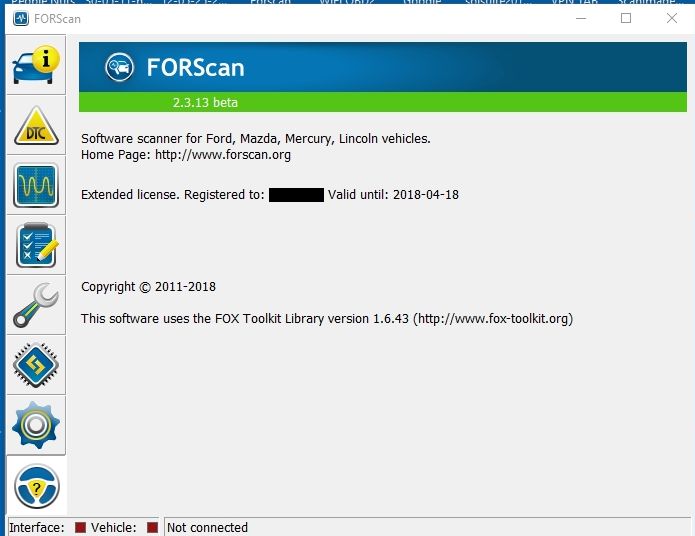

When done it should look like this:
Hope it works for you as well !!
