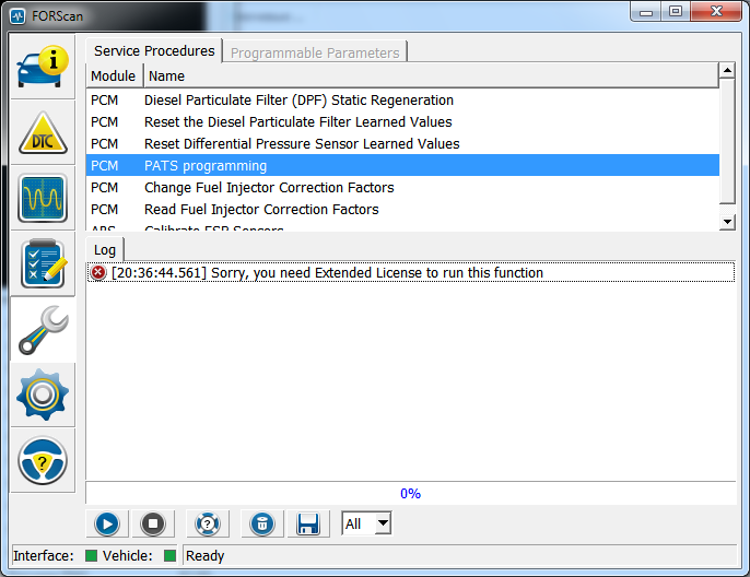

B. If you need an access to a function that is available under Extended license. If it is your case, please do not try to inquire for Extended License unless you see the following message:
List of functions that require Extended license:
Note: the functions may be implemented not for all models. Please either check for your car support in Change Log on the Download page, or check for the function presence in the functions' list when FORScan is connected to the vehicle,
Service -> PATS Programming
Configuration and Programming -> Module Configuration
Configuration and Programming -> Module Configuration(AS BUILT format)
Configuration and Programming -> Central Configuration
Configuration and Programming -> Module Reset/Configuration (required to learn central configuration changes related to these modules)

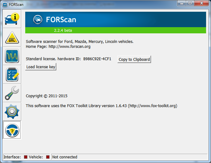

1. Copy the Hardware Id from the About chapter of FORScan:
Important note: you need the hardware id of the equipment that directly works with your vehicle. So if you have a desktop and laptop, and you use the desktop to review the logs and the laptop is used to connect to your vehicle, you need to get the Hardware Id of you laptop!

5. FORScan with correctly applied extended license should look like this:
