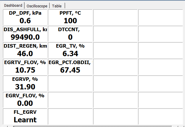

I own a 2010 Mazda 3 1.6 MZCD.
The last july I changed the DPF because it was clogged.
A few weeks before changing the DPF I filled the additive fuel tank. Everything was working perfect.
Thanks to FORScan, in November I installed by myself the cruise control switches and activated the option.
Since I activated the Cruise Control (I don't know if it's a consequence or just a case) DPF regenerations started to be more often (actually the DPF regenerates every 60km). After each regeneration I connect with FORScan and I find the P2458 error.
I don't know what to do anymore: the last week I had to fill again the additive fuel tank. I even changed the differential pressure sensor. The mechanic that done all the work said he controlled other things regarding the DPF (as pipes, EGR and others) and everything is ok.
I kindly ask you if do you have any suggestion? It's very boring having the error code and having regenerations every 60km.
In the attachments I added a screenshot of some values read with FORScan while engine on and in idle.
Thank you in advance

The ash content is too high. You cannot burn ash only soot. It may need removing and cleaning.
