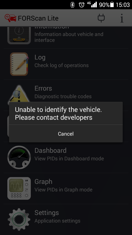

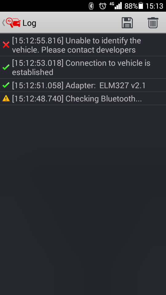

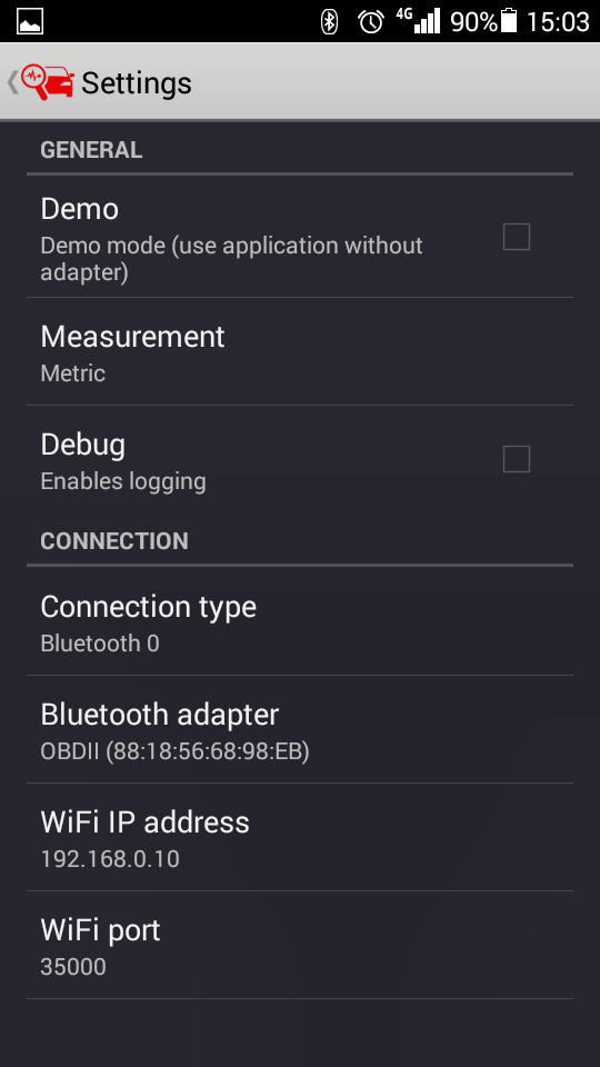

I'm an old user of Forscan windows version, but on android version, not working on my Ford Focus 2 2007 1.6 tdci 90 HP.
I'm attaching here some printscreens.
I try bluetooth 0,1,2.
On every other programs on android is working fine.

bluebear wrote:I'm an old user of Forscan windows version, but on android version, not working on my Ford Focus 2 2007 1.6 tdci 90 HP.
As far as we can see, the adapter says it is ELM327 v2.1, so if your adapter is not Vgate iCar, it seems to be a problem with adapter, discussed on our forum:
http://forscan.org/forum/viewtopic.php?f=4&t=22#p840
You said you work with Windows version successfully, do you use another adapter for Windows/
