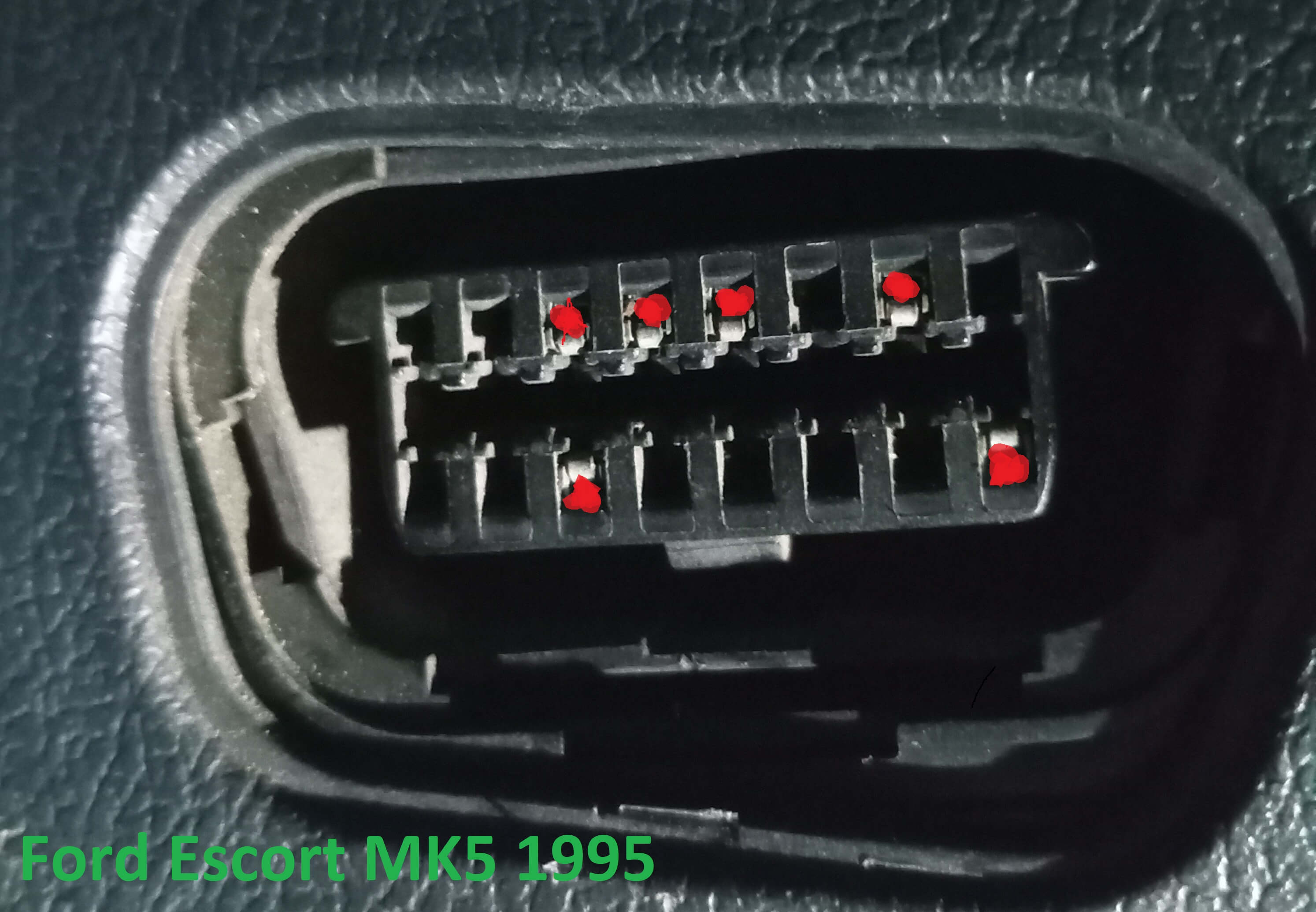

Hello,
what device i need for my Ford Escort MK5 year 1995 ?
Connector Ford Escort MK5 1995
Thank you :)
