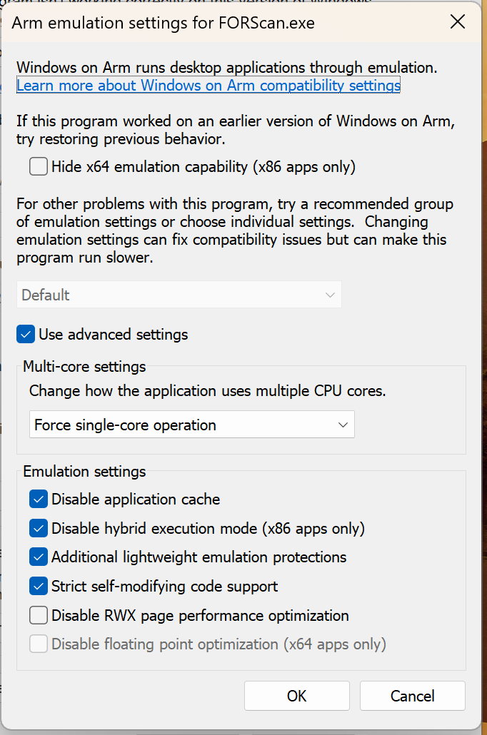

For anyone still having difficulty, try setting the application to use only a single core for emulation:
Screenshot 2025-01-21 at 09.11.31.png (123.76 KiB) Viewed 12999 times
I can report success with these settings on an M4 Max, macOS 15.1.1, VMWare Fusion 13.6.2, Windows 11 guest.
sragsdill
Joined: Thu Aug 02, 2018 11:02 pm
Vehicle: 2018 F150 Lariat 3.5L Ecoboost SCrew
Re: How to run FORScan on Windows computer with ARM CPU
Post by sragsdill »
Thank you KazWolfe that did the trick!
