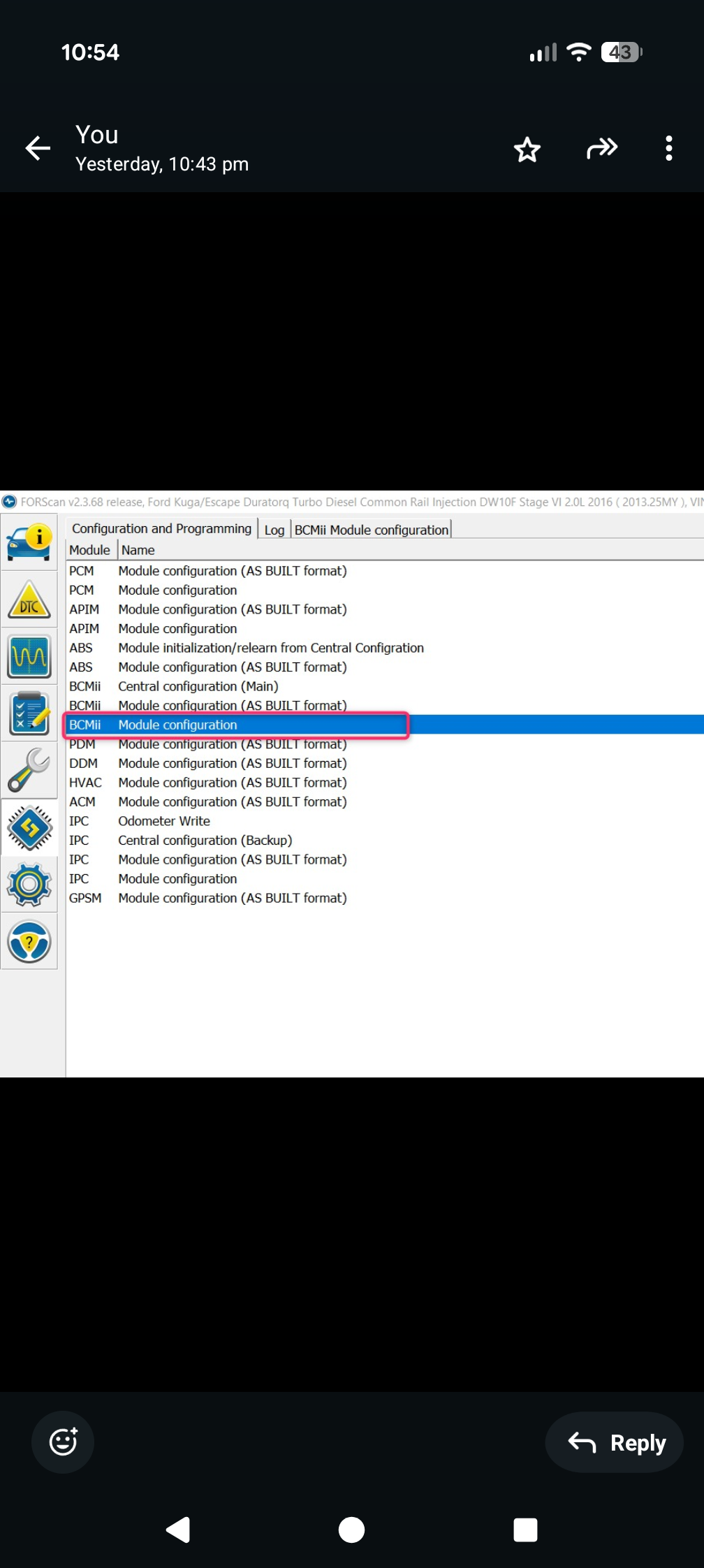

Hi guys trying to disable TPMS sensors in Ford Kuga 2016 2.0 Duratorq diesel.
Have done this in my Ford smax however the process on Forscan looks a bit different and I am struggling to piece it together.

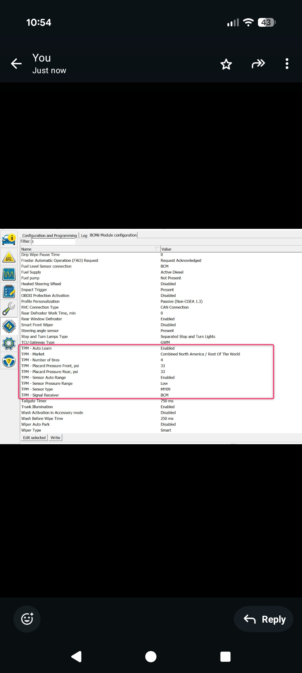

I can't find any references to the TPMS system on ForScan I can only find TMS in the BCMii module config
Hoping TMS is not Temp Monitoring System
In the BCMii module there are a selection of various options but none to clear cut disable the system.
Any one done this previously any help would be appreciated
Attached are screenshots of Forscan
Ford Kuga TPMS Disbake

Hi, I did this on my 2015 Kuga. Here are my modifications; I hope it's the same for you.
The images are not loading.
In engineer mode 2, in BCMII, you need to find: tire pressure monitoring system and change it to "not configured" instead of "TPMS FedReg EU".
Next, in the IPC, you need to find: indicators-Tire Pressure Monitor and change it to "disabled" instead of "enabled".
And still within IPC, you need to find: deflation detection system and change it to "Disabled" instead of "enabled"

I have tried to attach the file again
What you describe above is very similar to the SMax config maybe this Kuga has been modified in some way
- Screenshot_20251225-105430.png (356.57 KiB) Viewed 641 times
- Screenshot_20251225-105435.png (502.49 KiB) Viewed 641 times
