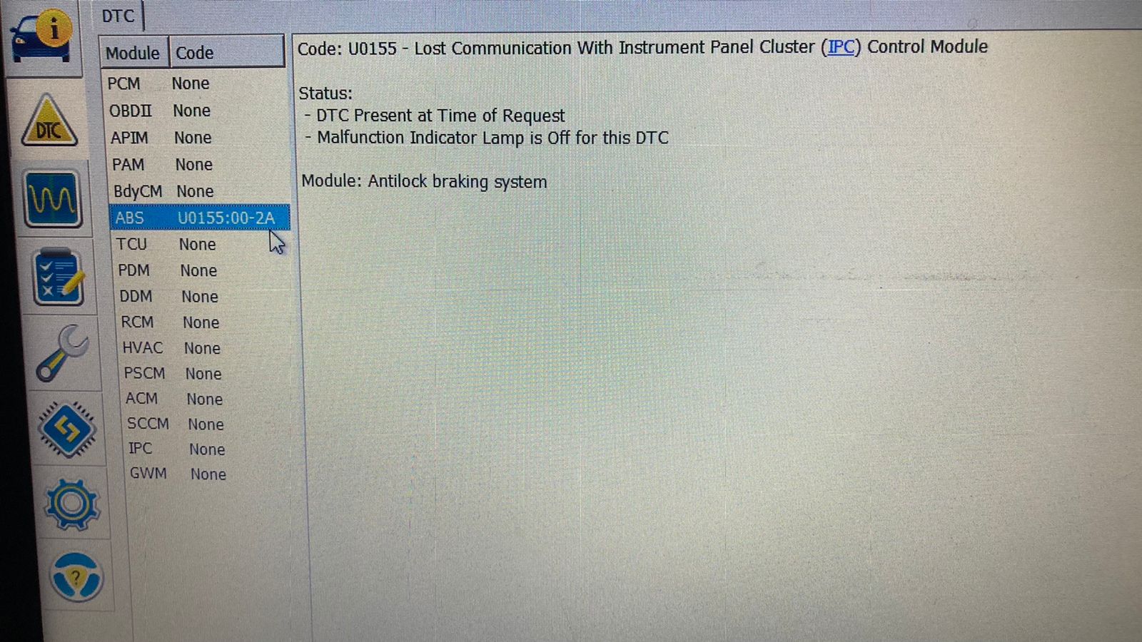

does anyone know how to clear this DTC U0155 from ABS module, while searching over the internet i found TSB SSM 49954 will have solution however it's not yet released.

HI, Found this online while I was struggling with this error on My car. Seems like there is nothing to worry about.
it Says "Some 2018-2021 EcoSport vehicles may have diagnostic trouble code (DTC) U0155 stored in the ABS module. This DTC will not cause observable conditions or warning indicators for the customer. If this DTC is detected while diagnosing unrelated conditions, it should be disregarded."
