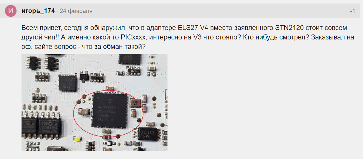

and someone on February 24 found that there is still a different chip :(

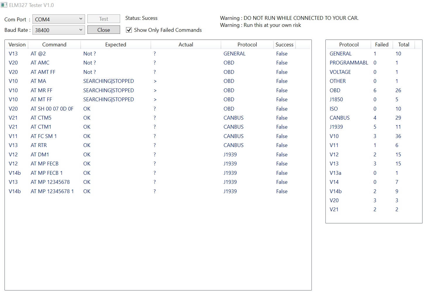

My Test :!:
Interface:
Port: COM4, 2000000 kbps
Type: Prolific
Adapter: STN2120 v5.5.0 (ELM327 v1.4b)
Min.delay: 0 ms ( Excellent)
Errors: None
