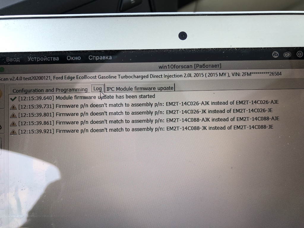

What does it mean?
IPC programming
Stetsovsky

Re: IPC programming
This shows up if you already have modified the firmware. Or your dealer has.
I guess none of my modules has original firmware left. So I see this message every time i touch them.
With Forscan 2.40 I modified every Module exept APIM and PSCM (I was warned by Forscan NOT to do this)
Best regards
Karsten
Best regards
Karsten
