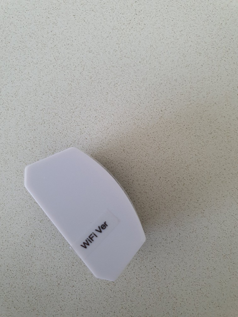

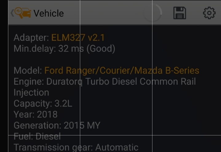

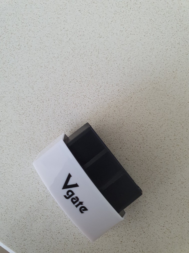

Hello Everyone,
I wanted to share my experience with chinese OBD2 and Forscan on Android.
I used to connect to Forscan on my laptop using Maxisyspro ecu flash device, however recently I found out that I can monitor EGT temperature on my 3.2 L diesel Ranger, thus I wanted the same facility on my mobile phone.
Using my bluetooth ELM327 and torque pro I couldn't find the same PID, thus I downloaded Forscan lite and with my bluetooth ELM327 it can see the adapter but never connect to vehicle.
After some search I reached this thread and found out that wifi ELM327 works better with Forscan so I ordered Vgate 3 wifi and today it reached and I was able to connect from the first attempt.
Still I want to find a way if I can add the same PID to torque pro as I can display the gauges on Sync3 screen using android auto. But for a connectivity with forscan mobile it was successful using the below adapter.
