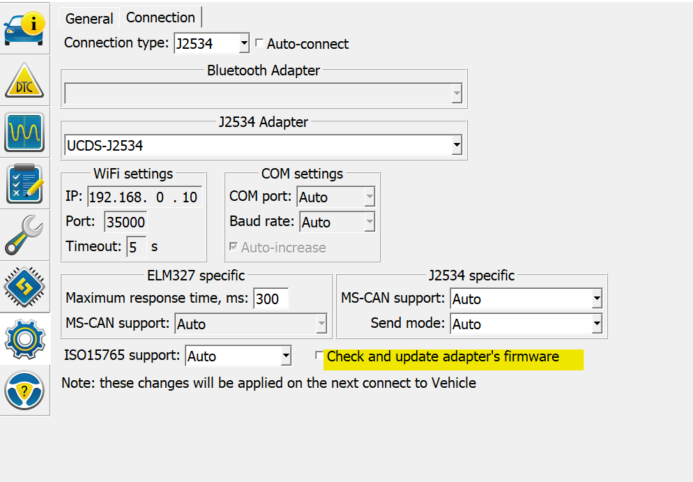

I have updated Forscan to the latest version, I have connected my ELS27 adapter to the car and to the pc and when I connect in the program it tells me to update the firmware! Forscan doesn't realize I have an ELS V3 so he tells me to upgrade, but I know I don't have to. But a lot of people may think it's okay to upgrade, so it kills their adapter.
As they say to update because some problems have been solved, I have to think that my ELS V3 is not reliable and it would be better to get a new one? Or I can continue to use it safely without problems.

deselect
