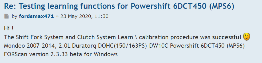

Hi !
The Shift Fork System and Clutch System Learn \ calibration procedure was successful ;)
Mondeo 2007-2014, 2.0L Duratorq DOHC(150/163PS)-DW10C Powershift 6DCT450 (MPS6)
FORScan version 2.3.33 beta for Windows

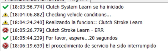

It doesn't work for me either. My car is a S-max Duratorq 2.0 from may 2010 and has a electric parking brake.
I have tried several times the Clutch System Learn procedure without success. It seems to start but after a while it finishes with error.
has anyone done it with similar model?
Thanks.

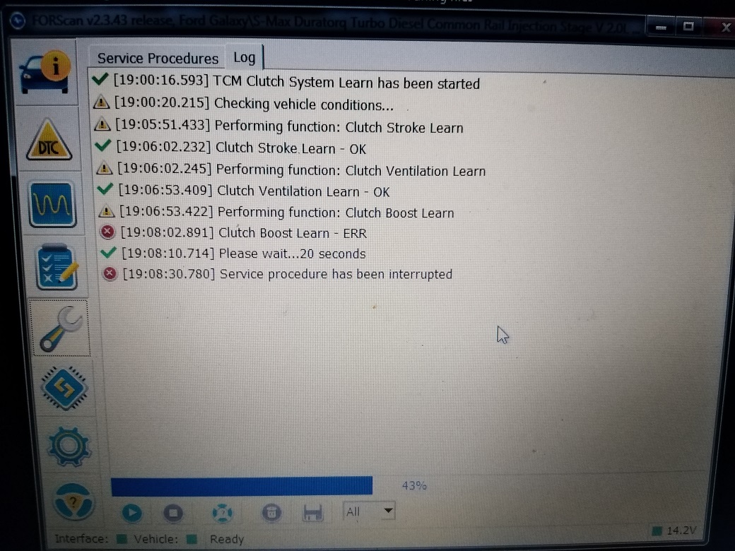

I have problem with Clutch learning. Full repair, new clutch and many other things, try with two different valve body (both fully working after repair), and every time procedure is interrupted after Clutch Boost Learn. Revs go to 5000 (not to 3000 as usual). Try different FORScan versions too. Any suggestions? Thanks!

Hello, did you ever get a fix? i have the same problem with the rpm in boost, only i get the tc p0949-00 2f thanks john.
