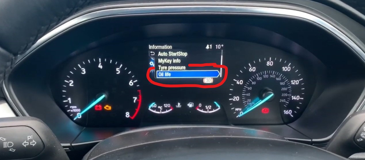

Can anyone advise me how to turn on OIL life MENU on Focus MK4 (2019) 1.5 Ecoblue using Forscan? Thanks!

Easy. Go to IPC direct config menu, disable Oil change reminder and enable Oil Minder Distance/Time

Its working! Thank you! :shock:

The above procedure does not work on the 2019 Ford S-Max on IPC.
When I disable the oil change from the settings in IPC, the oil life box disappears.
When I turn it back on and also turn on the Distance / Time Oil Minder, despite this, the life % of the oil does not show... :/ ;)

When I disable oil life minder and enable the time/distance I get the display, but both both are always empty "--".
When I set it back my normal oil life comes back and shows % only which is the default for my car.
