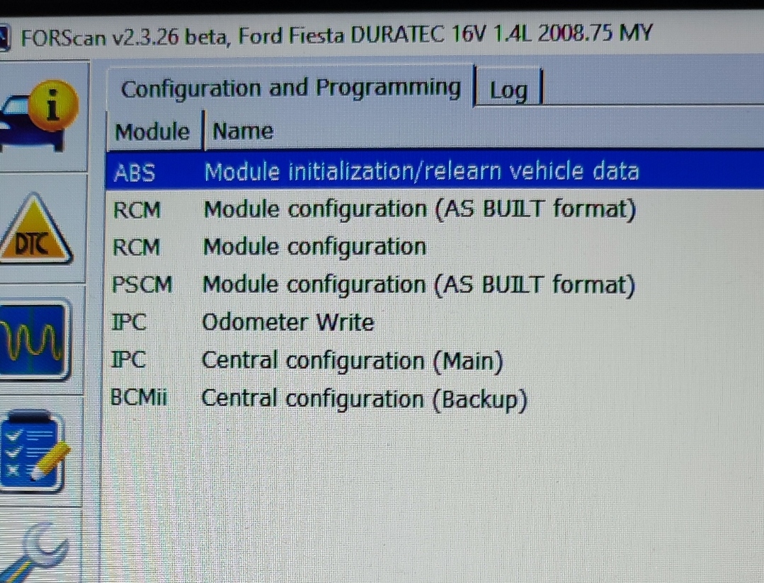

(A) The issue I am facing is there is no option to backup the ABS module.
As I understand it, (but stand to be corrected), this is because this model year fiesta uses central configuration, as such the abs module gets its config centrally.
I have tried the module initialisation / relearn vehicle data' on the current faulty unit to no avail.

Just an update for anyone facing similar in future.
I was able to fit and programme used module.
Having fitted the unit original code was gone, new code for incompatible configuration present, ran the ABS initialisation and relearn vehicle data procedure and cleared codes, all fixed!
Abs self test KOEO successful
only outstanding issue is calibration of longitudinal acceleration sensor, when trying to run it it says not supported.

What scan tool did you use? I have the same issue with my 2010 Fiesta Zetec, I am using a ELM327 adaptor, I can do most functions, but I cannot initialise the ABS module, keep getting message operation not supported.

BradK82 wrote: Thu Nov 07, 2024 1:12 pm What scan tool did you use? I have the same issue with my 2010 Fiesta Zetec, I am using a ELM327 adaptor, I can do most functions, but I cannot initialise the ABS module, keep getting message operation not supported.
Hi I used modified elm327 OBD500K, it has the HS / MS switch. From tunnelratelectronics.
