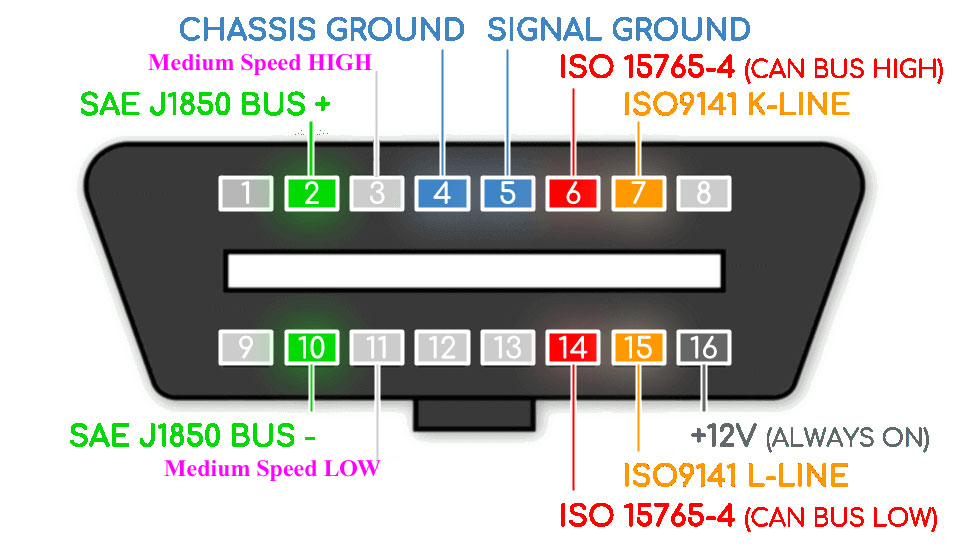

Did you try to see if PIN 16 has battery power?
