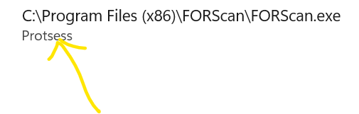

Re: FORScan won't run on Windows 10/11 with Bitdefender installed
Kuvatõmmis 2024-02-07 210459.png (9.25 KiB) Viewed 13974 times
