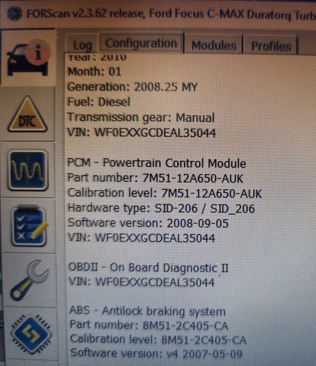

I've the same issue there but even trickier.
I don't have the PCM firmware update option available but only the PCM (As-built). I'm running the latest available Forscan version (2.3.62) with vLinker FS (up to date too).
I've the "free" 2 months extended licence activated and I'd like to know if it would change anything to pay for the extended licence.
Also I don't know where to find if the PCM firmware update of my car would be supported by Forscan latest beta versions.
Anyway, I'm lost and don't want to get charged 100€ by the local stealer to find out that there's no firmware update available in orde to fix the BST 27/2012 (snags on the original ford mapping of Siemens injectors that leads to instabilities at idle and at low charge around 1700rpm)
So is there is by any chance a list of firmware updates concerning my PCM ? Can I get the option to see it with a full paid extended licence?

Anyway, I'm lost and don't want to get charged 100€ by the local stealer to find out that there's no firmware update available in order to fix the TSB 27/2012 (snags on the original ford mapping of Siemens injectors that leads to instabilities at idle and at low charge around 1700rpm)
Thank you very much for your acertaining.Answered in the previous post....you must have a paid licence. Read it again & if you decide to pay the tiny fee, make sure you read the information in the hidden beta private forum so you fully understand what it can do, the risks involved & make sure you're using a recommended cable.
I tried today and successfully found out that my PCM is up to date from Ford database point of view.

My PCM runs by 7M51-AUK and my injectors nozzels PN end by 3, my car has all the symptoms described in the summary BUT the assembly plant is in Saarlouis (WF0..) the build code is AL.
What next ? should I update and see ?
