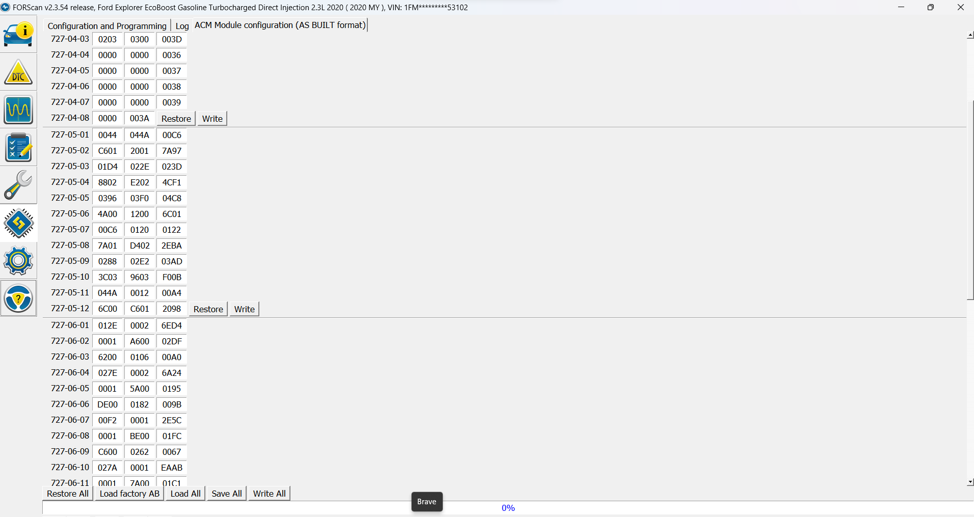

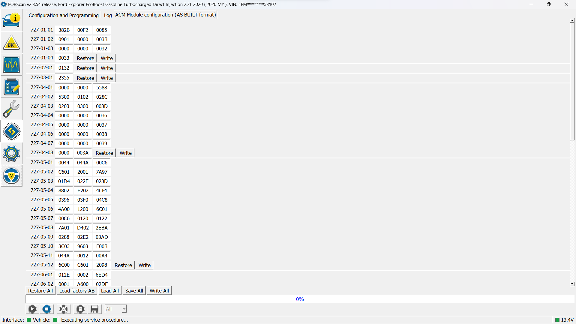

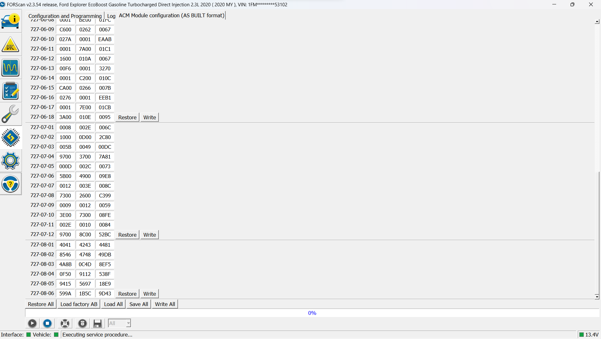

I have a 2020 Explorer XLT which has been imported from the US to the UAE. The radio frequencies are odd and the built-in maps are not available. I would like to change the region from the US to Middle East. I've attached the screenshot from my most recent scan of the APIM. What numbers/codes to I need to change in order to set the region to Middle East?

Start reading at the first post.
Your model may be more complex.
Visit a local dealer.
Ask to read the APIM part number is it works / fits your region.
With luck, the dealer can flash the vehicle with the correct firmware, language and maps.
