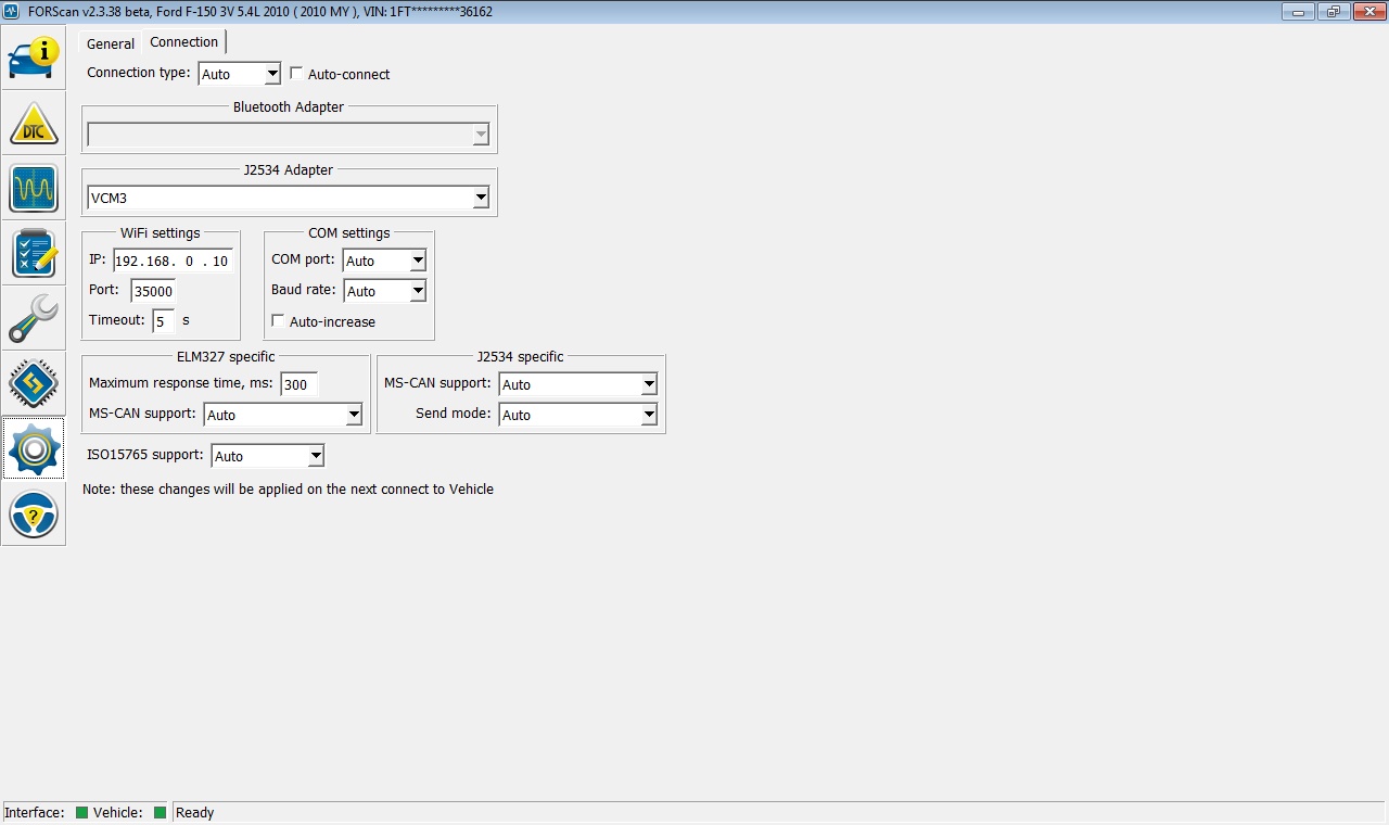

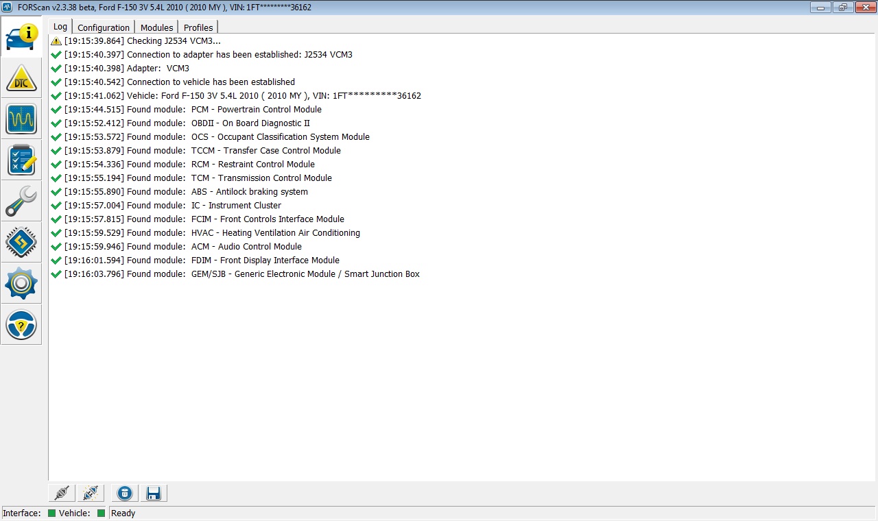

Re: Support of J2534 (Pass-Thru) adapters in FORScan v2.2.*
A recent test with the new Ford VCM 3 and setting it as a Pass-Thru device worked out quite well.
FORScan and the device will connect via USB and WiFi.
