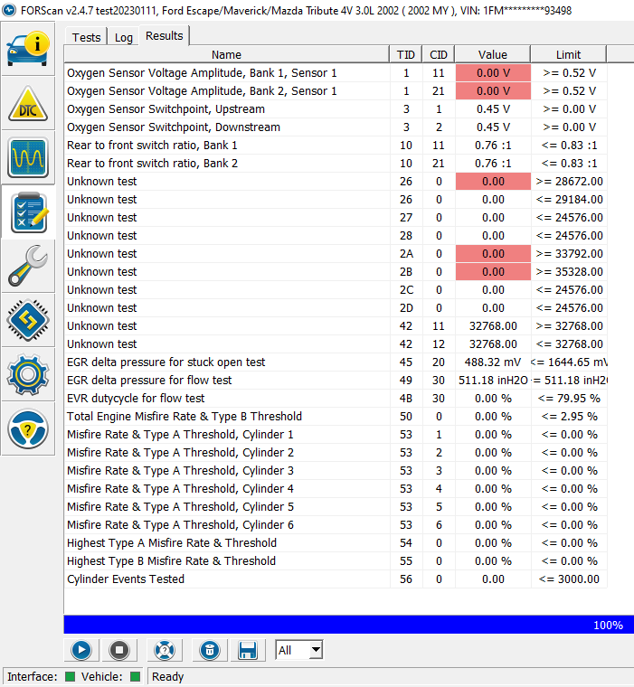

jSONBB wrote: Thu Jan 05, 2023 8:50 pm nonContinuousModeDetailedReport_2002__Ford__Escape__GLOBAL_OBDII__01052023152506.pdf
Report of non Continuous DTCs as reported by the Mitchell MD-350. FORScan does not know what multiples of these tests are - gives incorrect data output. I will update this with the list of DTCs from FORScan later today for comparison.
These are the missing "unknown" tests from FORScan, the Mitchell J2534 correctly reports them.
Correct test data pids
Pls update these in FORScan :)
This is how MODE 6 is identified with FORScan with a J2534-2 device and Bluetooth adapter.
You are incorrect trying to operate that tool, all it did is generate a report from itself, NOT FORScan!
I do understand how to operate this tool, I am trying to show comparison for test data that FORScan doesn't understand; as it shows "unknown" in the Mode 6 list.

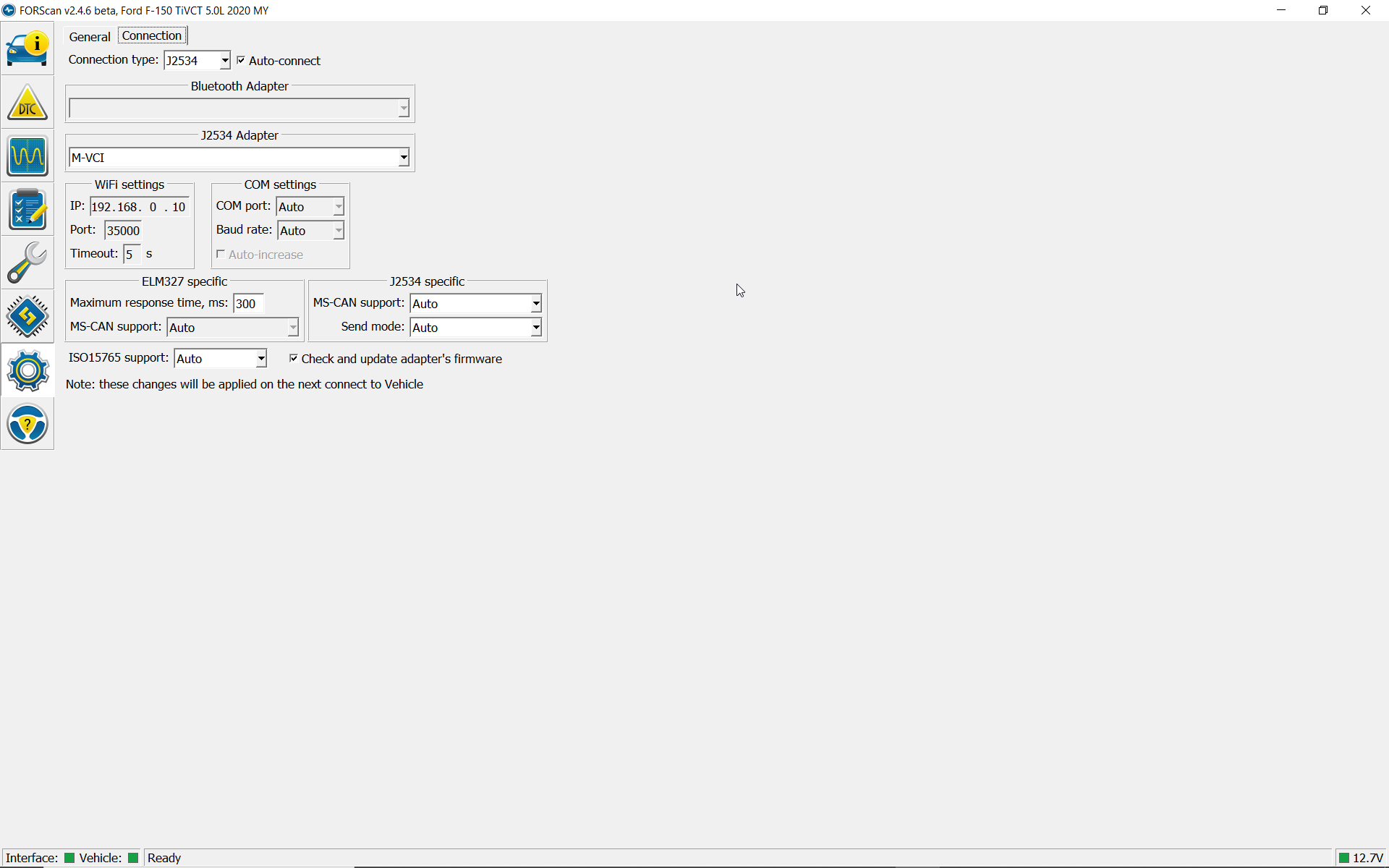

Bosch M-VCI (Mastertech)
https://www.boschdiagnostics.com/softwa ... osch-m-vci
Install Windows 7
1) M-VCI_Setup_v13.2.6.exe
2) M-VCI_Setup_v13.3.18.exe
Go to C:\Program Files (x86)\Bosch\VTX-VCI\VCI Software (M-VCI)\J2534 Configuration
Send J2534ConfigApp.exe to desktop
Install Windows 10
Use compatability mode for Windows 7 for both files
Use the USB connection NOT WiFi for diagnostics and programming.
All other applications will be on the desktop - Success with a 2020 F150 5.0L 4WD

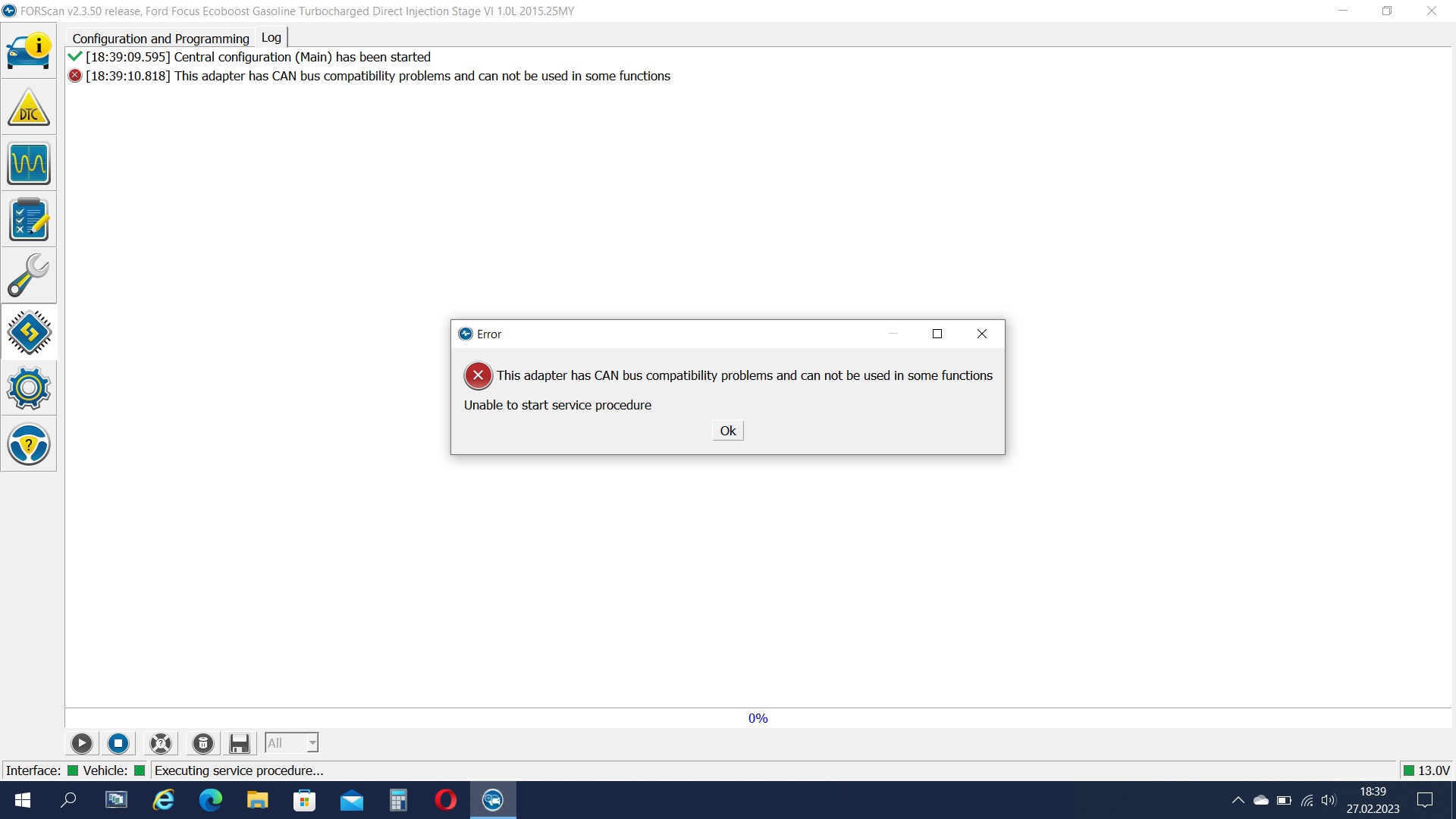

I can't program the BCMI Ford Focus MK 3.5 with the original UCDS cable. Message: the cable is not suitable. Everything worked last week.
I use: Forscan, IDS, FDRS, UCDS, Fordiag

anonymius wrote: Mon Feb 27, 2023 5:41 pm forscan-ucds.jpg
Same problem with the original VCM-II and VCM-3...
Posts: 2109
Re: Support of J2534 (Pass-Thru) adapters in FORScan v2.2.*
Post by tractmec »
vilkur wrote: Fri Mar 17, 2023 1:45 pm
Use the Support instructions at the heading "Providing FORScan Debug Information" at this link https://forscan.org/contactus.html!
