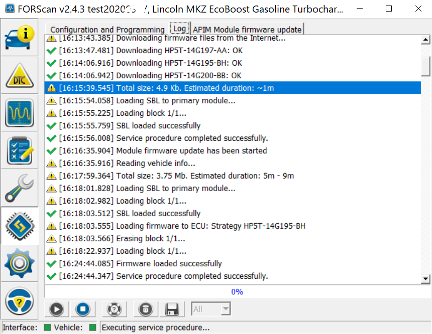

Got sent a link today to 2.4.3 test so loaded on laptop and had a go on the car. Followed the procedure and it seemed to flash ok 5 different parts. Said procedure completed successfully. Did a reset then went into asbuild and changed 7DO-02-03 from 0000 to 0600 gave me a checksum error but wrote anyway. Went into radio settings and option to switch on radio logos had appeared. Switched it on and checked logos in Dab and they were there and working. But as soon as i went off DAB they disappeared and cant get them back. Has APIM got right files in it do I need to try and see if there are more updates available ?

Halda wrote: Sat Sep 19, 2020 8:22 pm Got sent a link today to 2.4.3 test so loaded on laptop and had a go on the car. Followed the procedure and it seemed to flash ok 5 different parts. Said procedure completed successfully. Did a reset then went into asbuild and changed 7DO-02-03 from 0000 to 0600 gave me a checksum error but wrote anyway. Went into radio settings and option to switch on radio logos had appeared. Switched it on and checked logos in Dab and they were there and working. But as soon as i went off DAB they disappeared and cant get them back. Has APIM got right files in it do I need to try and see if there are more updates available ?
Wow, just figured out how to get 2.4.3. I'll see if it works tomorrow after eye surgery. Don't know when I'll be back on.
WhatsApp Image 2020-09-20 at 23.59.24.jpeg (164.44 KiB) Viewed 5595 times
The attachment WhatsApp Image 2020-09-20 at 23.59.24.jpeg is no longer available

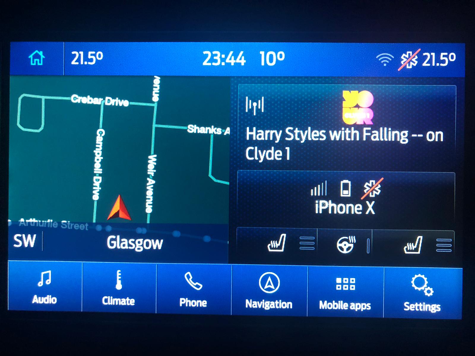

Success finally ! Had to update 3.4 ver 20021 to 3.4 ver 20196

Post by esqueue »
finally updated my AIPM software. Used 2.4.3 but still no calm screen options. Oh well, not worth bricking.
Screenshot 2020-09-21 174239.png (305.88 KiB) Viewed 5575 times

esqueue wrote: Tue Sep 22, 2020 12:47 am finally updated my AIPM software. Used 2.4.3 but still no calm screen options. Oh well, not worth bricking.
You can activate Calm Screen from APIM Module Configuration search for Calm Screen and select Enable then Write.

AHNA1711 wrote: Tue Sep 22, 2020 6:54 am
I activated via the asbuilt codes. When I checked this method, it already is set to enabled.
