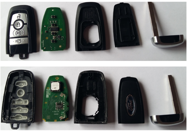

Remote start the car ( Ford S-Max 2.0 TDCi 2017 PowerShift )
4Button Remote smart Key 433 or 434 MHZ DS7T-15K601-EF (please see ford etis )
guide for Ford S-Max mk2
To activate Remote Start, first you need a new key fob with start button (part # DS7T-15K601-EF for S-Max mk2 with 434 MHz).
:!: Note ! remove the metal blanks from the keys, the car doors are closed and the handbrake deactivated.
Programming keys
Determine the backup slot of the passive key.
:arrow: Place the first programmed key in the backup slot. Press the START / STOP button.
Wait for 4-5 seconds, then press the START / STOP button.
Extract the first programmed passive key.
:arrow: Within 5 seconds, place the second programmed passive key in the backup slot, then press the START / STOP button.
Wait for 4-5 seconds, then press the STOP-STOP button.
Extract the second programmed key.
:arrow: Within 5 seconds, place the unprogrammed passive key in the backup slot and press the START / STOP button.
Car doors lock and opened, lights blink
Congratulations on your new key being programmed !!! :)
Now use Forscan to change the asbuilt-data
BCM module- configuration parameters
• Remote start - enable
IPC module - configuration parameters
• Remote start - climate settings- enable
• Remote start - front seat- enable (optional)
• Remote start - rear defrost – enable (optional)
• Remote start - steering feel – enable (optional)
some guides recommend
RTM module - configuration parameters
don't change anything :!: ( old keys can also be used in the future )

Thanks will see if i can manage to make it once I get the key. One more question, my fob has 2 parts , the detachable key and the remote , where is the transponder located?? My key lookd like this one https://sc01.alicdn.com/kf/H12bd10b3e43 ... .jpg_.webp ( i know this is not the correct one)
