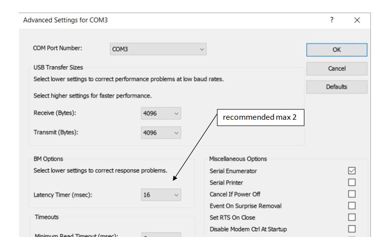

I ran a preliminary test and posted my results here:
https://www.f150forum.com/f118/forscan- ... ost6458386
The OBD Link EX is about 15 times slower than my ELS27, but I realize it's still a work in progress.
I'll try it again when the new drivers are out and it has more time to mature. For now, I will recommend the OBD Link EX, but only to people who want a 'cheap' adapter without the HS / MS switch.
Re: OBDLink® EX
you are fine with this FTDI driver setting :?:
