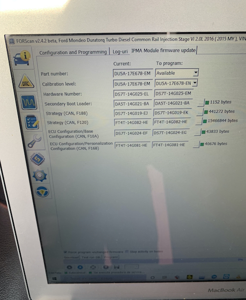

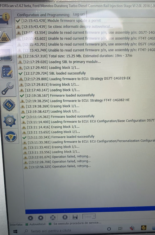

I broke I think with a clone of UCDS PRO + IPMA module ... when writing the block FT4T-14G081-HE I got the message Failed ...... I then tried with the original Obdlink EX interface to rewrite it in Forscan but it does the same ... it stops writing the last block ... how could I rewrite it ? please help !
Forscan 2.4.2 , Obdlink EX
Re: ReFlash dead Module with Forscan 2.40???
try this option
"Stop activity on buses "
ddg71
Posts: 44
Joined: Sat Jun 27, 2020 10:54 am
Vehicle: Ford Mondeo 2.0 TDCI Powershift, 180 HP, mk5, 2016
Post by ddg71 »
fordsmax471 wrote: Sat Sep 19, 2020 12:18 pm try this option
and "Force program unchanged firmware" ?
ddg71 wrote: Sat Sep 19, 2020 12:36 pm
yes
if this still does not work, install the files separately
1.
...21..
...19..
...82..
do not turn the ignition off
2.
...21..
...24..
3.
...21..
...81..
