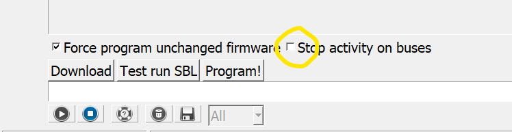

I used stop activity buses
how flash one by one ,use "stop activity buses" ?

first test at the beginning without modification "stop activity buses"
Re: 2014 explorer ipc flash faild
only this
first programming---> SBL: boot and Strat: 26-...
second reprogramming---> SBL: boot and Calib: 88-...

first programming---> SBL: boot and Strat: 26-... don't use stop buses
second reprogramming---> SBL: boot and Calib: 88-...use stop bues
is it right?
fbstn wrote: Mon Oct 19, 2020 5:30 pm first programming---> SBL: boot and Strat: 26-... don't use stop buses
is it right?
no :!:
first programming---> SBL: bootloader and Strat: ET4T-14C026-BL
and
second reprogramming---> SBL: bootloader and Calib: ET4T-14C088-BL
