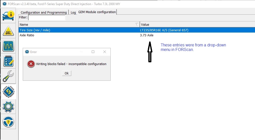

Issue: FORScan will not write to Generic Electronic Module.
Vehicle: 1999 Ford F350 7.3L Lariat 2-wheel drive manual transmission
Steps:
Connect to vehicle
Click on "computer chip" Icon
See two entries for Tire Size and Axle ratio "not configured"
Choose proper listing from the drop down menu
Click on Write icon.
Receive error "Writing blocks failed - incompatible configuration
Seems like dropdowns are not sending properly formatted variable to be written
FORScan v2.3.40 beta on Windows 10
Writing to GEM 1 Notation 2021-05-19 143849.jpg (79 KiB) Viewed 5829 times

I have the same issue using Forscan 2,43 April21 on my Focus 2011
with BV6N-BCM Module.

I had the same with my FF3. FORScan v.2.3.42 with Viaken v3.
Try to delete the profile and let FORScan read all the modules. Then, try to write changes to the configuration in the same session.
It worked for me.
