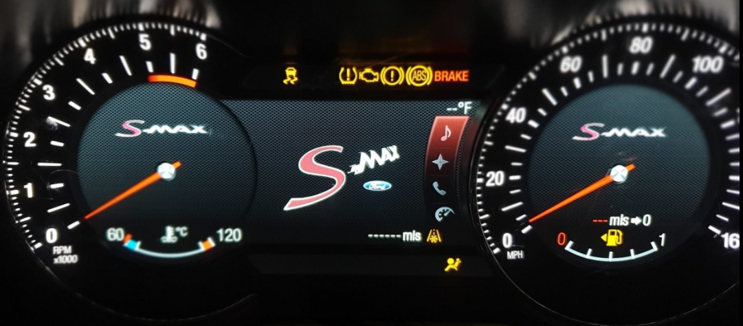

S-Max Logo foto.png (612.5 KiB) Viewed 13507 times

Can say that I flashed my IPC to full digital without a problem with Forscan. I've done it 100 times now and never experienced a difficulty. Templates uploading goes quick (5 to 10 min) So everything is working fine.

Yes you can upload whatever graphics you want to the IPC. Graphics are made with an online app. Pimp My Ford...
https://pimp-my-ford.web.app/ipc
Basically you prepare your VBF file and flash it to the IPC. Thanks to Szendo (Pimp My Ford app) and Chemikus (German MK5 forum) all this is possible. :mrgreen:
