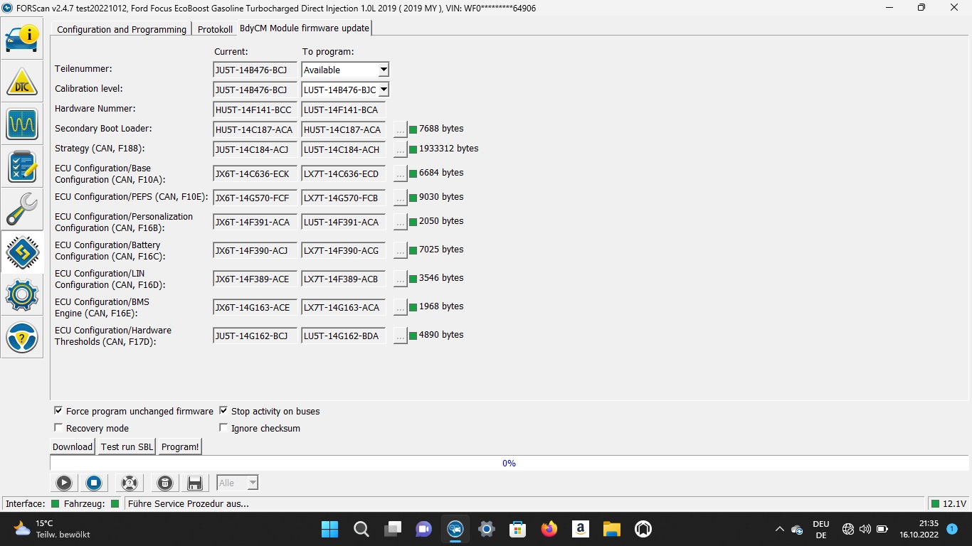

Today I have tried to flash the BCM on my Ford Focus MK4 2019 to the latest BJC Version. The reason are battery problems, so not just for fun.
Ive use the latest Betaversion of forscan.
So the flashing itself went through without any problem.
No errors or whatsoever.

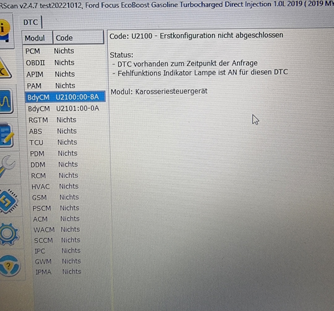

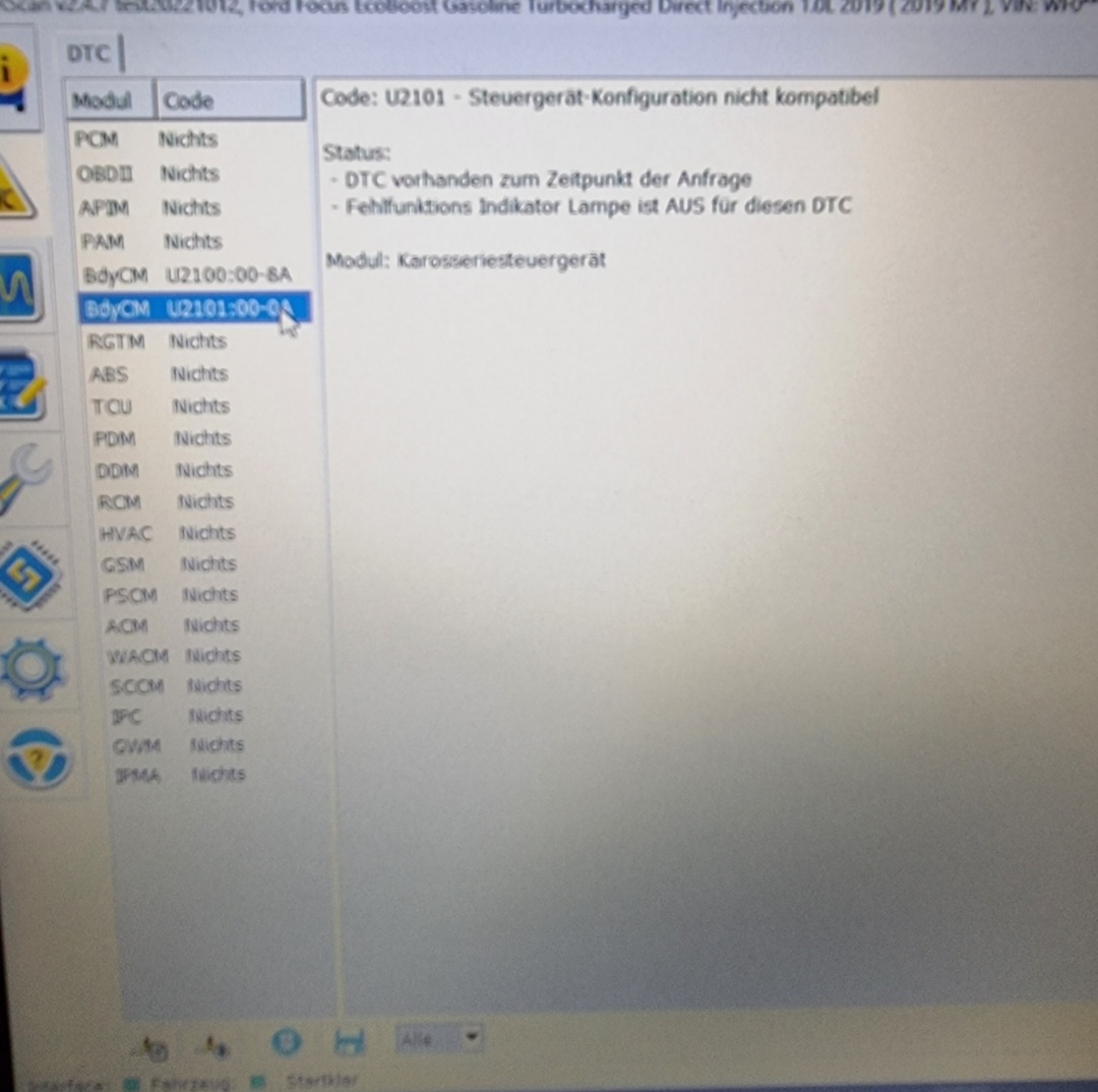

After the Update I have 2-3 DTCs:
U2100:00 8A Configuration not completed
U2101:00 0A Configuration not compatible
and one DTCs about the BCM storage, which is gone after a BCM reset. Most annoying thing is that the interior and trunk light is flashing when ignition is on. I loaded the asbuilt factory and made a reset of the BCM but DTCs and flashing light didnt go away.
So I flashed the BCM back to factory firmware. This also went through without any problems. Flashing interior light and DTCs also appeared but went away after BCM reset and never came back.
What did I do wrong? Please help!
Log of flashing:
(OK) [21:09:57.527] BdyCM Module firmware update wurde gestartet
(WARN) [21:09:57.539] Lese Fahrzeuginfo...
(WARN) [21:10:07.311] Loading and parsing factory As Built file...
(WARN) [21:10:54.519] Total size: 7.5 Kb. Estimated duration: ~1m
(WARN) [21:10:56.827] Loading SBL to primary module...
(WARN) [21:10:58.402] Loading block 1/1...
(OK) [21:10:58.875] SBL loaded successfully
(OK) [21:10:59.158] Service Prozedur erfolgreich abgeschlossen.
(OK) [21:15:58.325] BdyCM Module firmware update wurde gestartet
(WARN) [21:15:58.336] Lese Fahrzeuginfo...
(WARN) [21:16:40.172] Loading and parsing factory As Built file...
(WARN) [21:18:43.755] Total size: 1.88 Mb. Estimated duration: 3m - 5m
(WARN) [21:18:46.498] Loading SBL to primary module...
(WARN) [21:18:48.065] Loading block 1/1...
(OK) [21:18:48.532] SBL loaded successfully
(WARN) [21:18:48.567] Loading firmware to ECU: Strategy LU5T-14C184-ACH
(WARN) [21:18:48.569] Erasing block 1/1...
(WARN) [21:18:56.062] Loading block 1/1...
(OK) [21:20:52.273] Firmware loaded successfully
(WARN) [21:20:52.308] Loading firmware to ECU: ECU Configuration/Base Configuration LX7T-14C636-ECD
(WARN) [21:20:52.311] Erasing block 1/1...
(WARN) [21:20:52.548] Loading block 1/1...
(OK) [21:20:53.142] Firmware loaded successfully
(WARN) [21:20:53.168] Loading firmware to ECU: ECU Configuration/PEPS LX7T-14G570-FCB
(WARN) [21:20:53.169] Erasing block 1/1...
(WARN) [21:20:53.410] Loading block 1/1...
(OK) [21:20:53.964] Firmware loaded successfully
(WARN) [21:20:53.978] Loading firmware to ECU: ECU Configuration/Personalization Configuration LU5T-14F391-ACA
(WARN) [21:20:53.979] Erasing block 1/1...
(WARN) [21:20:54.127] Loading block 1/1...
(OK) [21:20:54.285] Firmware loaded successfully
(WARN) [21:20:54.299] Loading firmware to ECU: ECU Configuration/Battery Configuration LX7T-14F390-ACG
(WARN) [21:20:54.300] Erasing block 1/1...
(WARN) [21:20:54.445] Loading block 1/1...
(OK) [21:20:54.984] Firmware loaded successfully
(WARN) [21:20:55.008] Loading firmware to ECU: ECU Configuration/LIN Configuration LX7T-14F389-ACB
(WARN) [21:20:55.011] Erasing block 1/1...
(WARN) [21:20:55.154] Loading block 1/1...
(OK) [21:20:55.406] Firmware loaded successfully
(WARN) [21:20:55.441] Loading firmware to ECU: ECU Configuration/Signal Configuration LX7T-14G163-ACA
(WARN) [21:20:55.442] Erasing block 1/1...
(WARN) [21:20:55.586] Loading block 1/1...
(OK) [21:20:55.737] Firmware loaded successfully
(WARN) [21:20:55.751] Loading firmware to ECU: ECU Configuration/Hardware Thresholds LU5T-14G162-BDA
(WARN) [21:20:55.753] Erasing block 1/1...
(WARN) [21:20:55.898] Loading block 1/1...
(OK) [21:20:56.230] Firmware loaded successfully
(OK) [21:20:57.482] Service Prozedur erfolgreich abgeschlossen.

Updating the firmware of the BCM is one of several solutions told by ford to fix the loading strategy of the ford focus MK4. This is a special MK4 problem, other models will be also affected.
The solutions for the fix include:
- Updating BMS Sensor - Installed the latest CB Version.
- Updating TCU Firmware - Already done by ford.This took hours.. This was done causw TCU sucked on the battery even the car was off..
- Updating BCM to the latest strategy calibration.
- In some cases when the battery is already dead: Replacement of the battery. I already have a new one at home, but will replace it after everything else is done.
So: Still I am trying to update the firmware. I can flash it without problems - no errors while installation - but cant erase the two DTCs when the latest BJC Version is installed.
including flashing dome and trunk light.
The BCM is not bricked. I can flash it back to factory again without problems and the DTCs are gone.
So I need help how to fix the U2100 and 2101 DTC which are only when the latest BJC Firmware is installed. Loading factory asbuilt and rewriting everything to initialize the BCM didnt help. A module reset didnt help..

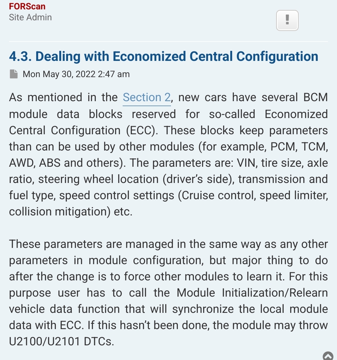

Try this:
https://forscan.org/forum/viewtopic.php?t=17208
or visit the local dealer and see if the correct configurations can be set for your model.

I am reading this but dont know what to do exactly?
Here are exactly my two errors mentioned.

With a power supply attached and the ignition ON, go to each module and reinitialize each one.
In other words "Configuration and programming function - Module initialization/relearn from Central Configuration":
Initialize the controllers in the list if provided.
