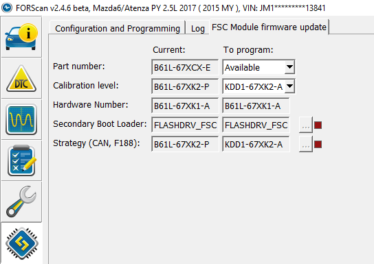

However I don't quite understand the version numbers. For example "FSC" module:
Code: Select all
FSC - Forward Sensing Camera
Part number: B61L-67XCX-E
Calibration level: B61L-67XK2-P (latest known: KDD1-67XK2-A)
Strategy : B61L-67XK2-P
VIN: JM1GL1V59H1113841
Is it normal that prefix and suffix for Calibration are changed? (B61L -> KDD1, P -> A)

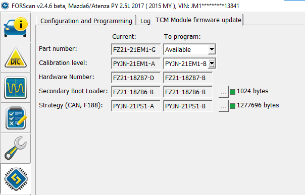

Or "TCM" module - suffix for Hardware Number will be changed from "D" to "B":
Code: Select all
TCM - Transmission Control Module
Part number: FZ21-21EM1-G
Calibration level: PYJN-21EM1-A (latest known: PYJN-21EM1-B)
Strategy : PYJN-21PS1-A
Re: Mazda 6 - firmware update
It is normal to change those letters, that is how Ford or any other advanced repair shop would know if any changes or updates were applied to a control module. The changes can be tracked backwards.

You're right, everything went smoothly :)
Firmware was updated, no errors.
