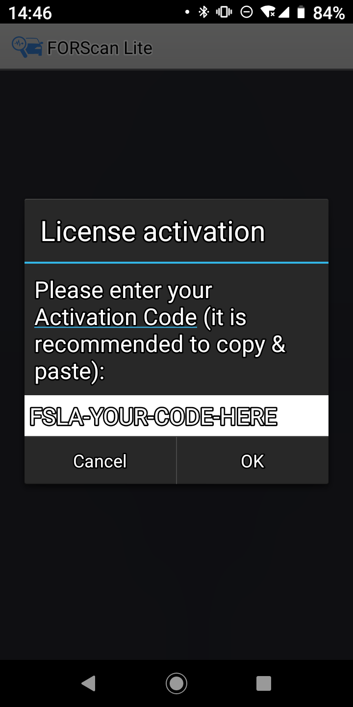

I tried it today and got this come up.
Message on my phone.png (110.71 KiB) Viewed 886 times
So what pin number are they talking about. This has never come up before, the Android tablet works ok. Apart from the 1...8 I don't have another number and that one doesn't work as that is only for pairing. The phone sees the OBD in the Wifi section.
Joh150413
Posts: 225
Joined: Fri Oct 19, 2018 10:18 pm
Vehicle: Taurus,3.5 Ecoboost, 2016
Re: Device not Authenticating
Post by Joh150413 »
It's asking for the code that you got in the email after you paid for the app.
Post by Mareng »
Perhaps so John, but that was 6 years ago, I have no recollection of any code except the pairing code mentioned previously.
I have uninstalled and reinstalled in the past without any problems, added to my 2 phones without this original code. Checked my password book and nothing in there either so I would assume when downloading from the PlayStore then one wasn't required.
Maybe Forscan moderator can help me out with this.
