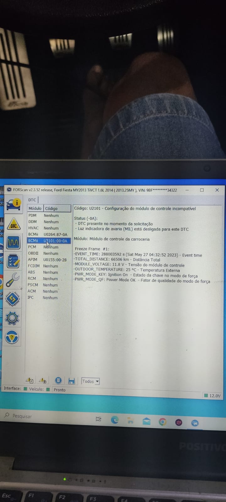

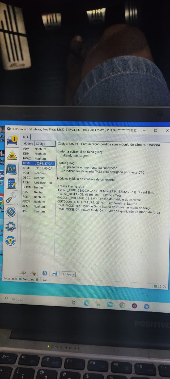

Hello everyone, good evening, I have several dtc errors, I would like to correct them. I have the following errors:
APIM U0155
BCMii U2101
BCMii U0264
what reasons and how to fix them grateful.
APIM U0155
BCMii U2101
BCMii U0264

the only thing I changed was to add the autopilot, otherwise don't change it.
