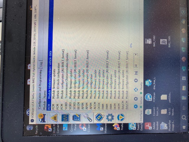

Thank you for the information. I did purchase the best 327 adapter with the USB port as recommended on this forum and use it to attach the OBDII to my Windows laptop. I'll download the app you recommended and get a few screen shots.
- IMG_1686.jpg (133.11 KiB) Viewed 1128 times

Re: 2019 Lincoln MKZ Hybrid BECM configuration
It looks better when rotated without flipping my screen.
Scrolling down a slight offers more adaptation information for the BdyCM.

As can be seen in the screen shot, the BECM does not have a configuration line. Is it possible the hybrid battery age is in a different module’s configuration?
- Posts: 2433
Read the post above, scroll down for more information highlighting all of BdyCM lines / adaptations.

I read the post sir. But I’m curious what the Bdycm module has to do with the hybrid battery?
Don Ridley
- Posts: 1562
- Joined: Sun Apr 01, 2018 2:31 am
- Vehicle: 2016 Transit Connect
You need to open Bdycm module to see what options Ford has programmed.
