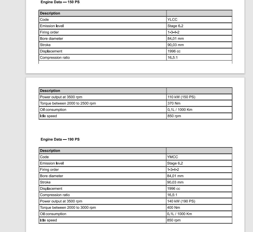

Panther EcoBlue Engine 2.0 110kw .Will it ever be possible to save a new configuration in the pcm to change from Panther A to Panther B.

It will not increase the power from 110 kw (150 HP) to 140 kw (190 hp).
The 110kw engine has a compression ratio of 16.5:1
The 140kw engine has a compression ratio of 16:1
And changing the map does not change the compression ratio. 150 versus 190 engines are different.
I also have an S-Max 2019 and I have 110kw and Forscan shows me 190. Which is stupid. ;)

They have exactly the same compression, there are no differences. The reason why it cannot be switched is that the pcm there are missing blocks so it is not possible to switch
Snímka obrazovky 2023-12-14 194746.jpg (99.52 KiB) Viewed 11128 times

The manual Mondeo mk5 ecoblue PCM does not have any other blocks, so it cannot be switched.
