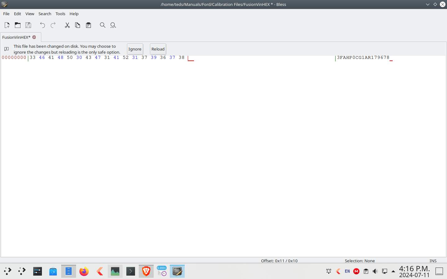

All those zeros should be either numerical or an Alpha character! The Last two characters on each line are a Check sum that is calculated during the writing of the Characters in the other positions(in the case above the check sums were calculated by writing the zeros)!
In all ABS modules I have seen so far, the VIN is Hex coded into those first characters address so those positions should not be all zeros up to the last two on each line!
You will need the VIN Number from the Vehicle you intend to install this in and a hex editor to install the correct characters into each of those Addresses(In Windows look up a program called Notepad++ with the Hex editor Plugin installed see link below)! I will attach an example of the VIN in HEX Code for my 2010 Fusion in a Hex editor!
My Fusions VIN begins as 3FA and ends in 678 so the hex characters will start with 3346 in the first four and end in 3738 in the last four
Example
760-01-01 3346
760-01-04 3738
Or in your case my Fusion would look like the below plugged in place of your zeroed ABS above!
You will have to type your VIN into a Hex editor(See Notepad++ https://notepad-plus-plus.org/, with the HEX Editor Plugin) In order to install the correct VIN Hex and again the last two characters will change depending on the content of the other positions(69, 6A, 6B and 6C are check sums for the Zeros in your post above and not part of the VIN hex)
760-01-01 3346 4148 5069
760-01-02 3043 4731 416A
760-01-03 5231 3739 366B
760-01-04 3738 6C
The above is just an example it is not correct for your vehicle!
The VIN in Hex Code will need to be hand typed into those address 760 sections of FORScan Configuration and Programming (AsBuilt format) ABS address 760 and click "Write all"! There will be a Check sum error alert but the write should proceed as the check sum will be calculated by FORScan during the write!
Some vehicles do have to have a Corrected VIN in the ABS and a PATS parameter reset/Pats Module Initialisation(see Wrench Icon PATS service procedure in either the IPC or the BCM) performed before the Engine will be allowed to start!
Hope this is not just confusing?
Do not know if this Helps?
