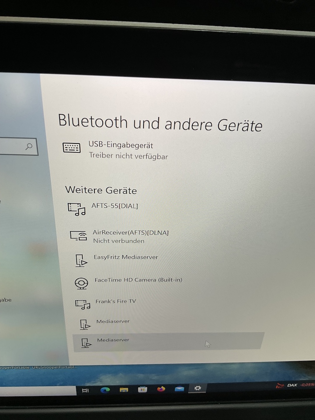

coyote67
Joined: Sun Jul 14, 2024 4:33 pm
Vehicle: Mustang 5.0 450PS 2021
Re: V-Linker FS over bluetooth with windows
Post by coyote67 »
It looks like Windows on Mac doesn't recognize this device at all, it doesn't even show an unknown device. But there are other devices in the household. I think the problem is that Windows and Mac aren't 100% compatible with everything. It's a shame.
