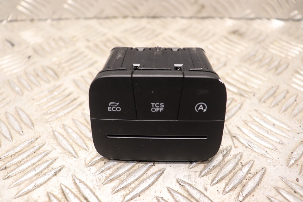

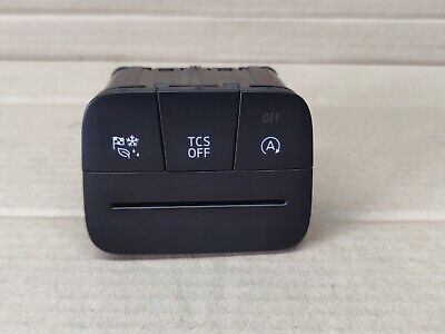

The drive mode selection panel must be as in the following picture:
and NOT:

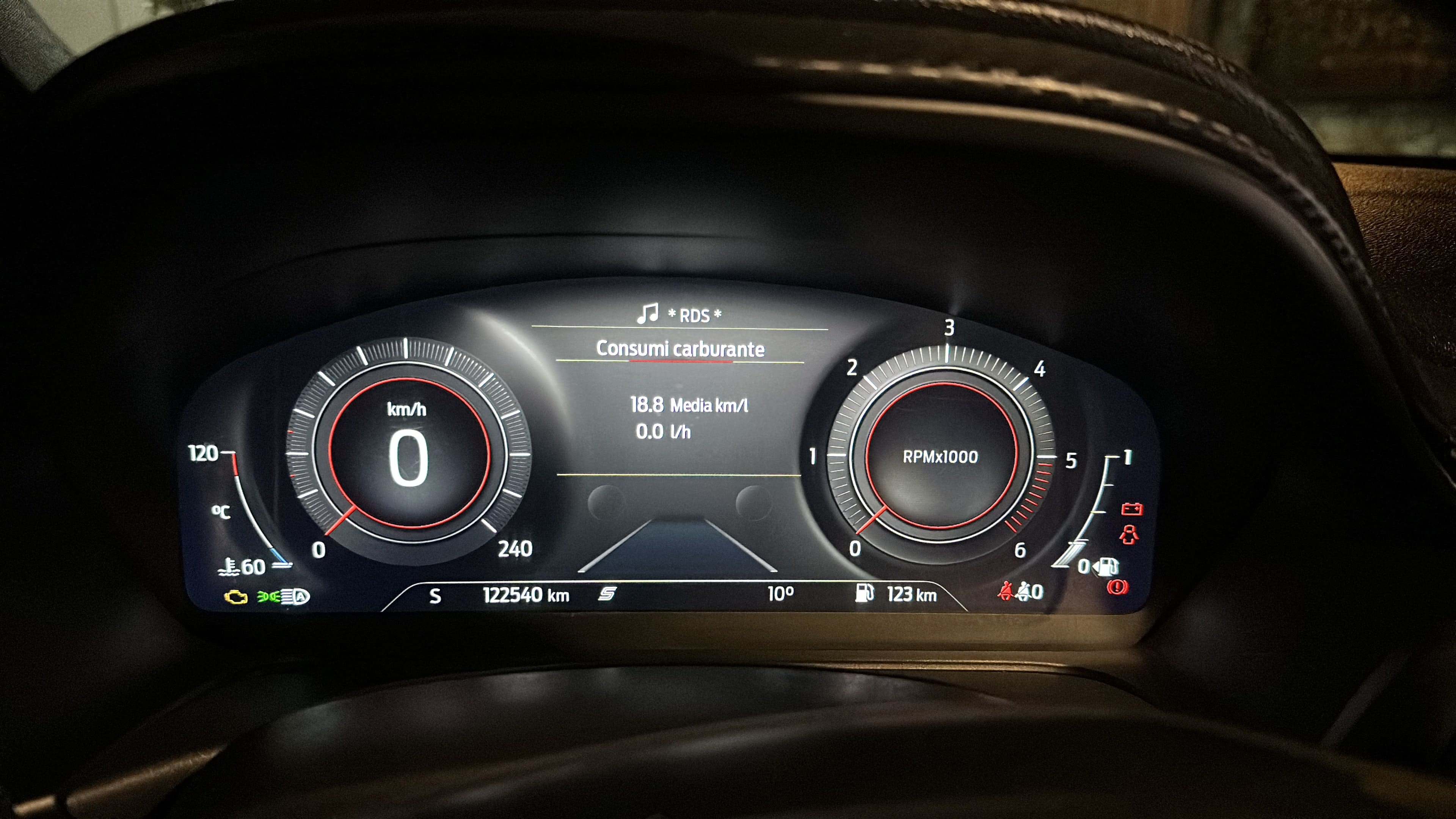

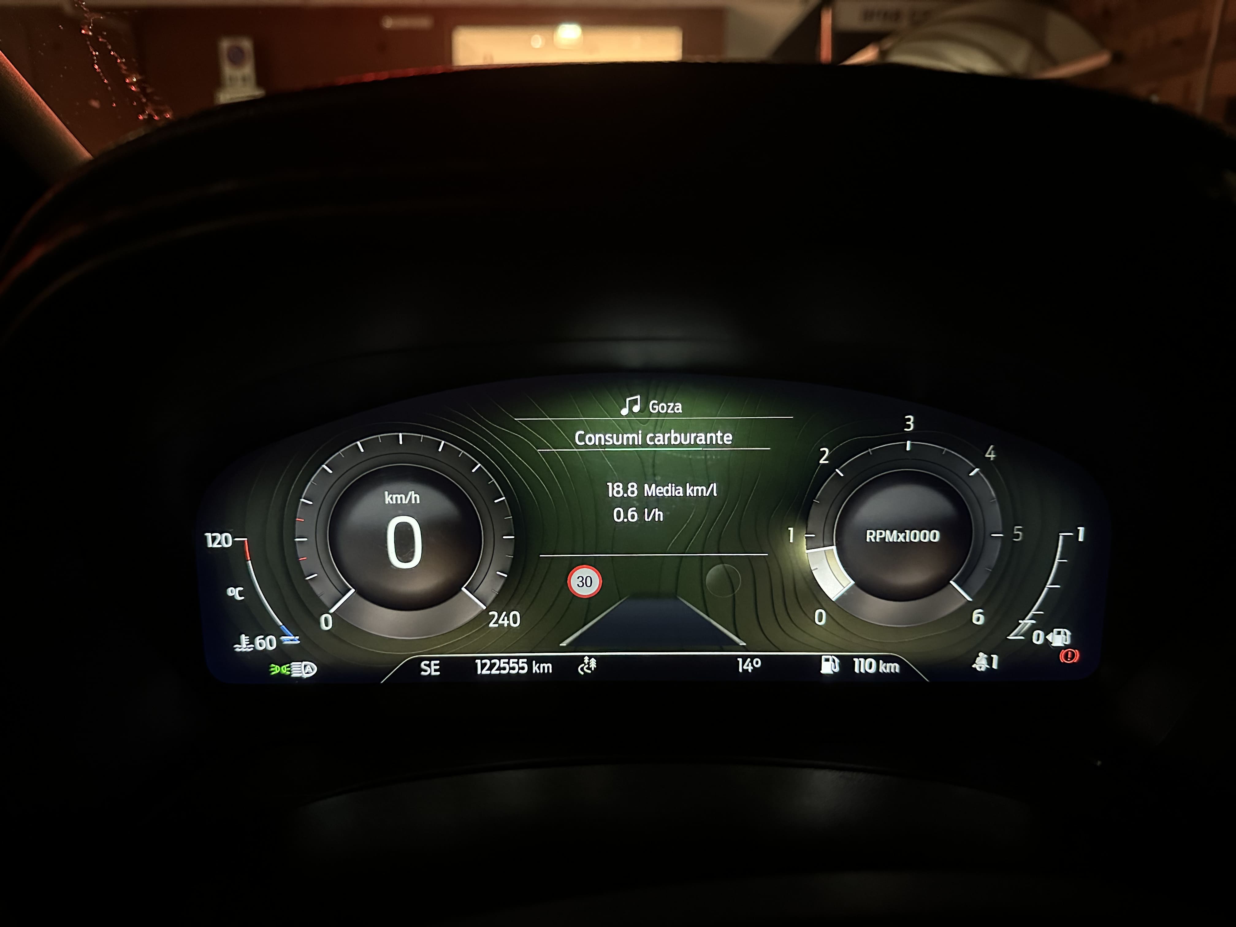

And finally...
