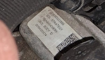

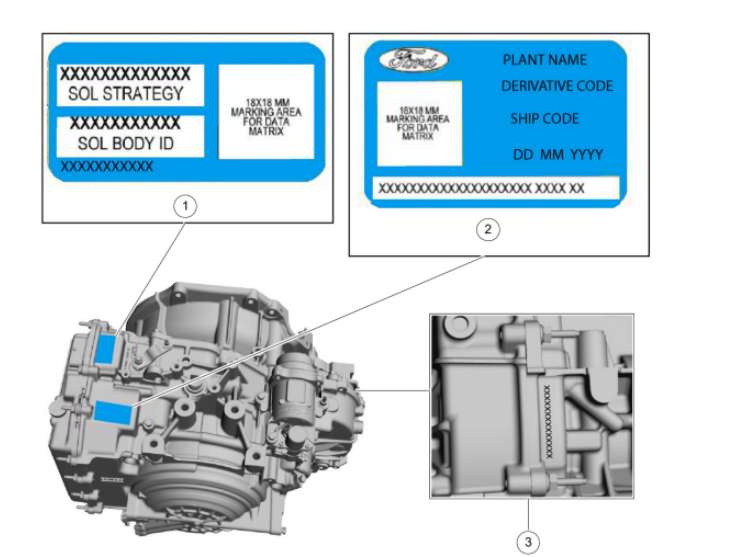

Just looking for the Strategie of the Gearbox, found this one :
I read that the Code should have 13 digits....
If i look at this , the Strategy Code would be : 2014180022888 (13-digit)
And Body ID : 0BA3454D9EB9 (12 digit)
Can anyone confirm that the Strategiecode looks like a Build date Number ?
But the Built-Date should be 20154120574, if the Info i found is right.
Info i found is :
