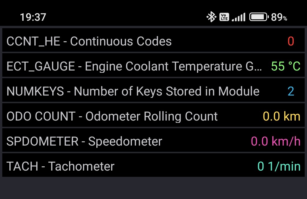

Jollycatman
- Posts: 4
- Joined: Sun Nov 09, 2025 9:29 pm
- Vehicle: Mazda 3 (BK) 1.6i 103 hp [2005]
Re: FORScan Lite does not display odometer data
Actually, this screenshot is from the Instrument Cluster data and as you can see, there are no odometer readings anywhere.
boosted_diesel
- Posts: 663
- Joined: Mon Jan 08, 2024 10:41 pm
- Vehicle: Mondeo/duratec he/1999cc/2002
That isn't enough pids to be all the data from the cluster matey.
