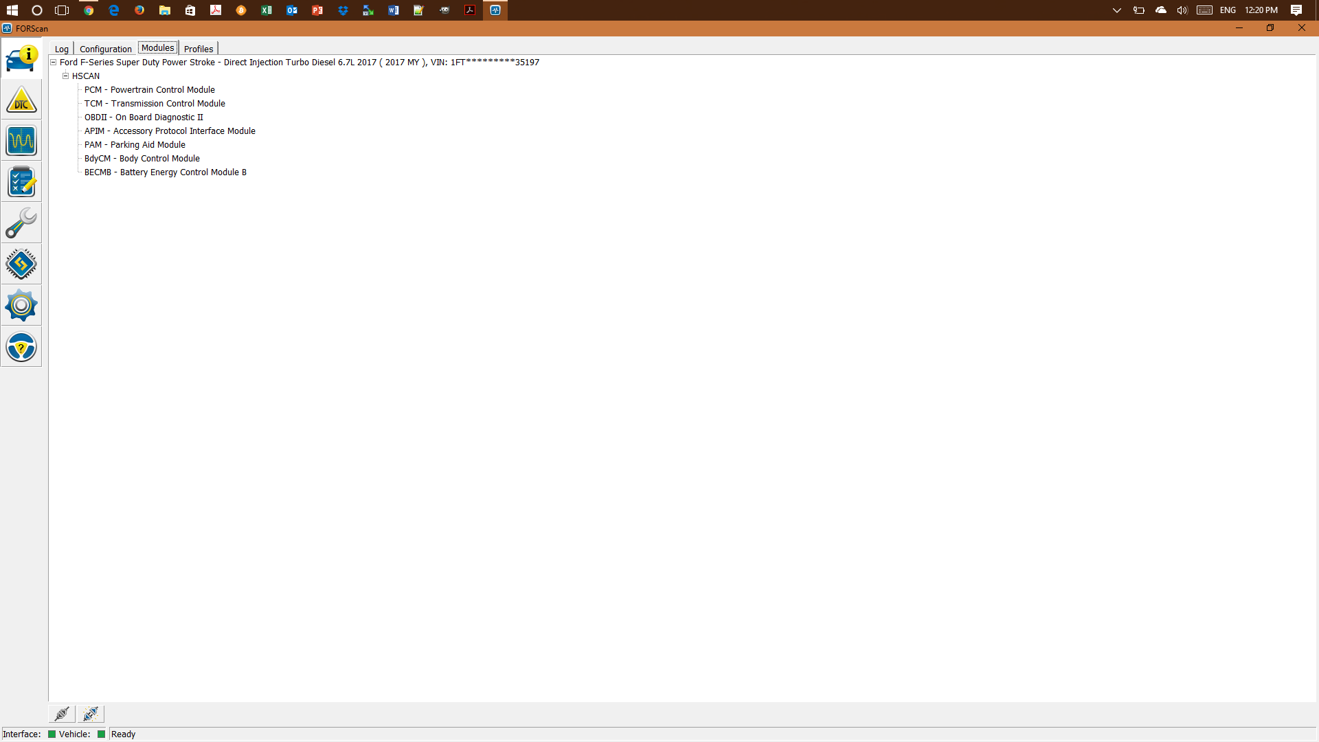

I am also not seeing the PDM/DDM modules. Only difference is I'm using the USB MX connector on a 2017 F350 Platinum. I never installed the OBDWiz tool, just Forscan and I've also optimized the connection getting a much higher 20000000 baud rate and 2ms latency.Garnet wrote:Your OBDII adapter must be used with FORScan to program your Ford's operating features. OBDWiz is only meant to be used to monitor vehicle operation and check DTCs. Not having access to a Raptor I can't verify any possible connection issues but my MX Bluetooth connects instantly, and brings up 24 modules in my 2016 XLT in about one minute on a Win10 laptop.

What OBDII adapter are you using? All I see is the HSCAN section. I'm using https://www.amazon.ca/ScanTool-425801-O ... B005ZWM0R4. I lied above, apparently it was the SX, not the MX. Mine is USB.Automate wrote:Here is an image from another user's 2017 F150 EcoBoost that does show DDM & PDM modules. It would be interesting to see a similar screenshot of yours and what modules are different.

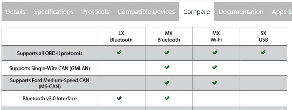

Only the OBDLink MX supports MS-CAN support without an external switch
Re: Missing DDM & PDM Modules - 2017 Raptor / OBDLink MX
I just ordered the MX. Wish I had understood this before I bought the first so I could have my programming done on my week home, but oh well, guess I can wait another 3 weeks.Automate wrote:Only the OBDLink MX supports MS-CAN support without an external switch
It's weird, because it says that it supports all OBD protocols, but I don't see HSCAN2 or 3 in my list that I see in yours.

Newer US Fords (maybe others) have the HS-CAN2 and HS-CAN3 buses. See this topic for more details
