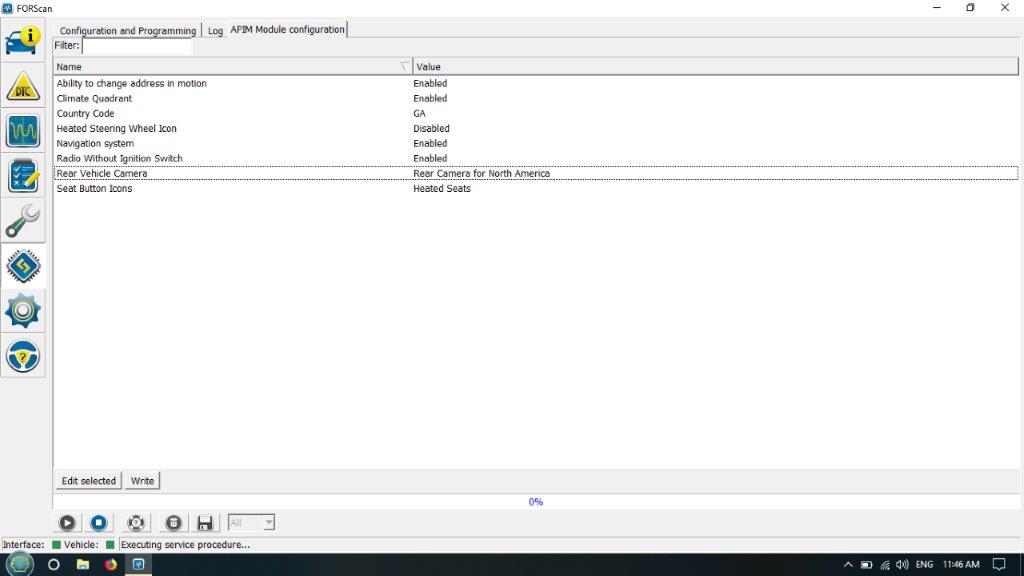

is there way to reprogram the nav system to work while moving like can do on older Sync 2 models?

Top line on this page and do a reset.

thanks ill give that a try under the APMI

Nope that didn't work that's on the Sync2 format. I have the Sync 3 updated version the screen shot shown isn't any the options listed on the actual module.

broome101 wrote: Wed Feb 20, 2019 9:09 pm Nope that didn't work that's on the Sync2 format. I have the Sync 3 updated version the screen shot shown isn't any the options listed on the actual module.
https://docs.google.com/spreadsheets/d/ ... edit#gid=0
in APIM try 7D0-02-01 x7xx xxxx xxxx.

Didn't work either I saw on the spreadsheet should be didn't work. ill try again tomorrow to change back and the add again see what happens. It worte it cause when I double checked it was 5753

After doing reset then doing it over she took and works perfect now. Thanks.
