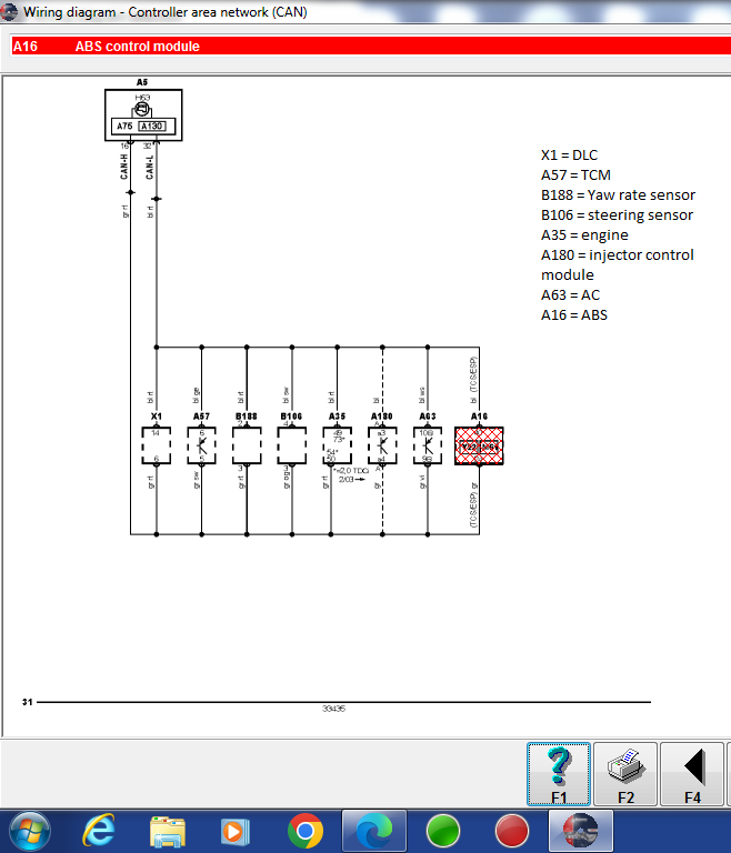

ok not sure if your car is hatch, saloon, estate/wagon.
the diagram below is for the DLC for the hatchback.
mondeo diesel 2006 dlc.png (99.41 KiB) Viewed 3690 times
this is for the CAN BUS high speed
2006 modeo diesel can high.png (68.34 KiB) Viewed 3690 times

It is a hatchback. Thank you much! The diagrams are too small - not possible to read wire markings.

Post by boosted_diesel »
All of the pin numbers are on the diagram. I can see them using my cell phone.

Yeah, I can see those, too. But cannot enlarge to make them easy to read. The resolution is kind of low. Would it be possible for you to print out those two diagrams and share with me (if not here - then privately)?
Interestingly, the DLC does not show any connections to pins 3 and 11 (which are expected to be wired to the MS-CAN bus) in these diagrams. As we can see above, Forscan finds modules on that bus and can communicate with them.

If you still need the diagrams give me a shout I can probably email them to you or something.
