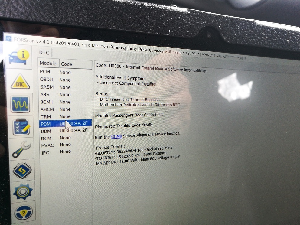

why this? after update code: u0300
is a solution?

marekrbk wrote: Mon May 06, 2019 1:01 pm Mondeo mk4 1.8tdci 2007 92kw
Forscan 2.4.0 test20190403
is a solution?
:idea:
Try what the troubleshooting says.
Run CCMii sensor alignment service function

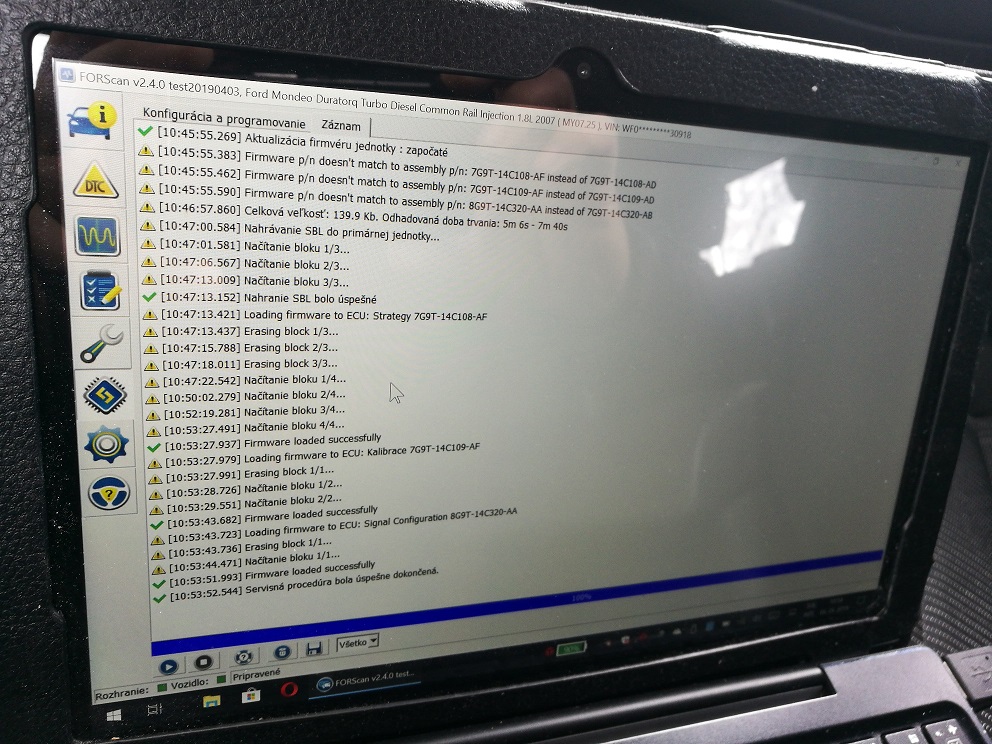

I updated the modules with original calibrations. all without mistakes. using ucds cable

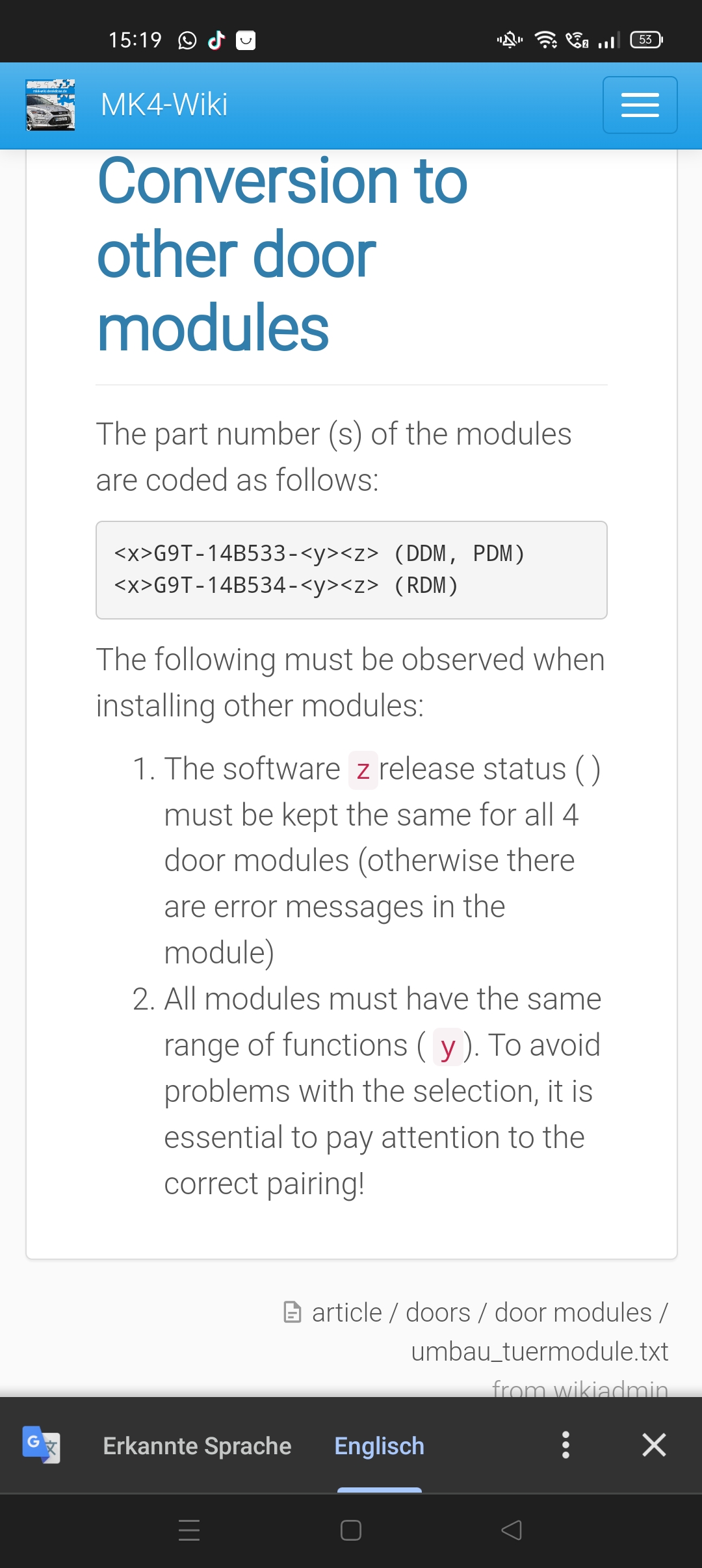

I have the solution for U0300.
If you update DDM and PDM to software with the last letter E or F, then the rear modules must have the same last letter. After that, the U0300 DTC is gone
